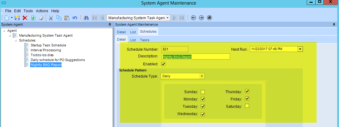

  1. Navigate to System Setup > System Maintenance > System Agent.
  2. On the left-hand side, expand Agent > Name of your Agent > Schedules.
  3. Expand the schedules that have the little leading arrow (which indicates that there are tasks tied to that schedule) until you find the schedule that has “Process MRP” under it.
  4. Then, click on Schedules > Detail and adjust the next run time/settings for this schedule as needed.
Interestingly, my times are accurate in the schedule, but they are actually being done an hour early. Does Epicor take in account the daylight savings time?
MRP will be attached to a scheduled task visible and editable via the system agent.
If your server time is not updated then the AGENT execution will be off by an hour!
