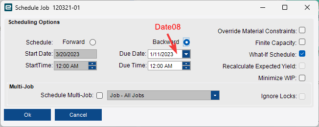

I am looking at our schedule for upcoming jobs. We don’t use MRP. We manually schedule the jobs as they are released. Often times the due date that the job is scheduled with is a placeholder date. We will process the job and ship it on our schedule, but that may not align with the dates in Epicor. Sales order demand dates are not reliable. This is due to many confounding circumstances, but it boils down to customer demands.
So, we have a list of jobs that are scheduled to ship in the next few months. From this list, I want to take a subset of jobs, and do a what-if schedule for them to see what will change if all these jobs are scheduled to ship this month (instead of in the next three months).
To this end I have setup a UD field in JobHead.Date08. This stores what I am calling the sales ship by date. This is the target our sales department wants to hit in order to make their monthly ship goals.
I used DMT to push in a sales ship by date into JobHead.Date08, for about 250 jobs. Now I want to use the date in date08, to run a wi schedule for the jobs in my list.
The only way I can see to do this, is to export my existing ReqDueDate for each job, then use DMT to update the ReqDueDate to the same values as Date08. Then I just sit back and wait for Global Scheduling to run and then look at my new schedule. If I don’t like it, I have to DMT the old dates back in to correct them, and then wait for global scheduling to reposition all the jobs again.
Am I missing something in the functionality that would make this easier? Open to ideas!

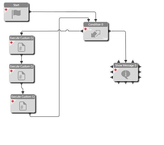

I am trying to use the MoveJobItem method. I am not getting very far. This is what I have setup in my UBAQ BPM:
I have a UBAQ that joins my UD07 table with JobHead. My UD07 table just has a list of job numbers and new dates. The goal is to look at the job listed in UD07, then (backwards, finite) schedule that job using the new date.
In the BPM the condition is looking for the Calculated_Flag field to be unchecked. As long as there are unchecked flags, the loop continues. Once all the flag fields are checked, the loop should end, having scheduled all the jobs on the UD07 list to the new dates.
The first Custom Code Widget: Look at the BAQ and pull the first row that is not flagged.
var xRow = (from ttResults_Row in queryResultDataset.Results where ttResults_Row.Calculated_Flag == false select ttResults_Row).FirstOrDefault();
MyJob = xRow.JobHead_JobNum;
NewDate = xRow.UD07_Date01;
The second Custom Code Widget: Schedule the job on this row using the new date.
var schedDS = new Erp.BO.ScheduleEngineDataSet();
var sp = (Erp.BO.ScheduleEngineDataSet.ScheduleEngineRow)schedDS.ScheduleEngine.NewRow();
sp["Company"] = callContextClient.CurrentCompany;
sp["JobNum"] = MyJob;
sp["AssemblySeq"] = 0;
sp["OprSeq"] = 0;
sp["OpDtlSeq"] = 0;
sp["StartDate"] = NewDate;
sp["StartTime"] = 0;
sp["EndDate"] = NewDate;
sp["EndTime"] = 0;
sp["WhatIf"] = false;
sp["Finite"] = true;
sp["SchedTypeCode"] = "jj";
sp["ScheduleDirection"] = "End";
sp["SetupComplete"] = false;
sp["ProductionComplete"] = false;
sp["OverrideMtlCon"] = true;
sp["OverRideHistDateSetting"] = 2;
sp["RecalcExpProdYld"] = false;
sp["UseSchedulingMultiJob"] = false;
sp["SchedulingMultiJobIgnoreLocks"] = false;
sp["SchedulingMultiJobMinimizeWIP"] = false;
sp["SchedulingMultiJobMoveJobsAcrossPlants"] = false;
sp["SysRowID"] = Guid.NewGuid();
sp["RowMod"] = "A";
schedDS.ScheduleEngine.AddScheduleEngineRow(sp);
using (Erp.Proxy.BO.ScheduleEngineImpl boSched = Ice.Assemblies.ServiceRenderer.GetService<Erp.Proxy.BO.ScheduleEngineImpl>(Db))
boSched.MoveJobItem(schedDS, out finished, out Msg);
Third Custom Code Widget: Check off the row that has now been scheduled.
xRow.Calculated_Flag = true;

I thought I had all the right pieces in place. What am I missing? I am also not sure how to define the start date. The whole point of scheduling is to figure out that start date. But I can’t leave it blank without error. How does Epicor define the start date for the Schedule Engine dataset that gets fed into MoveJobItem?

When I schedule a job in JobEntry, I just choose a target end date, then backwards finite schedule it to find the planned start date. However, the MoveJobItem method is requiring the ScheduleEngineTableset to include a start date. Is there another method that somehow creates this start date from the op standard estimates?
