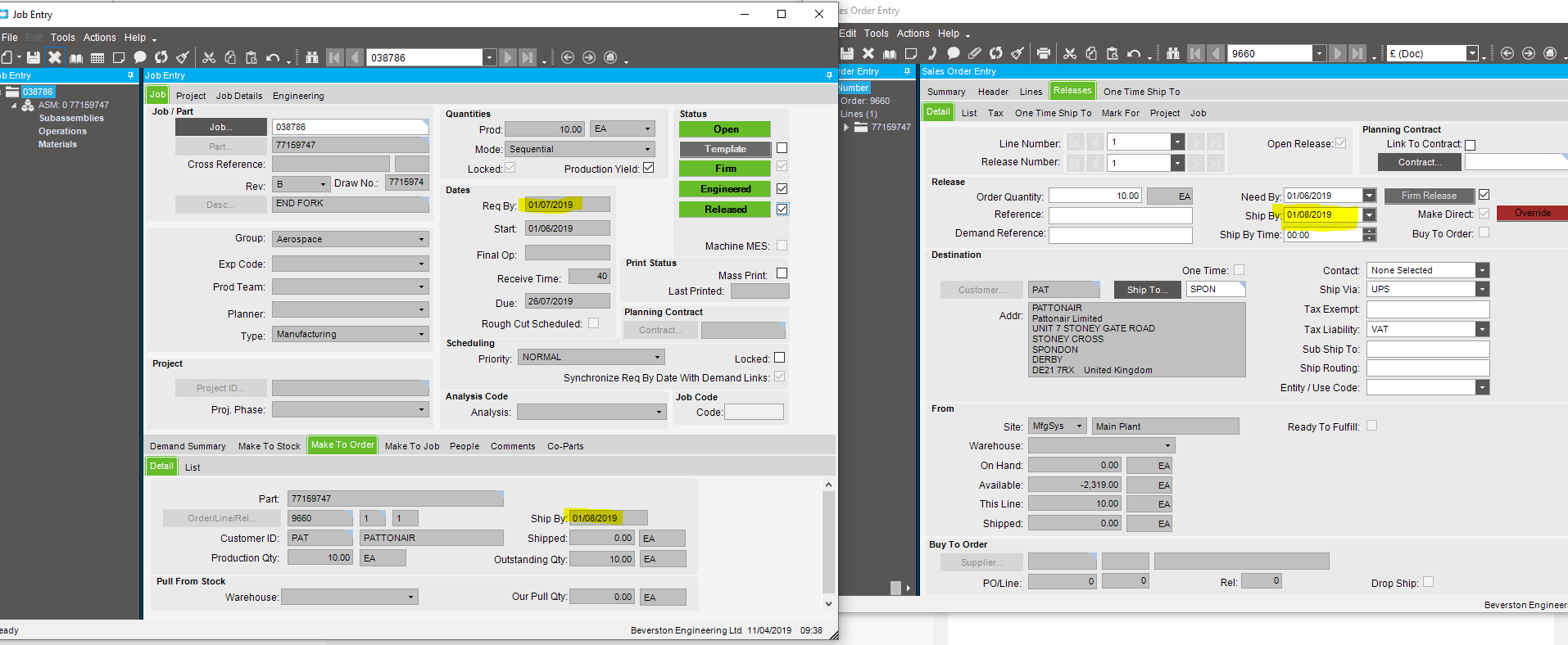

We have an updateable dashboard for rescheduling jobs so that we can reschedule whole orders a lot quicker. I did not write the code and I am unsure how to change it to make it do what we want it to. At the moment it will only reschedule into the future but we tend to move jobs out to the end of the year if we are unsure of delivery dates and then bring them back in when delivery is confirmed. At the moment we have to bring them back one job at a time which is very time-consuming. Here is the code. If someone could point me in the right direction I would be extremely grateful.
Adrian.

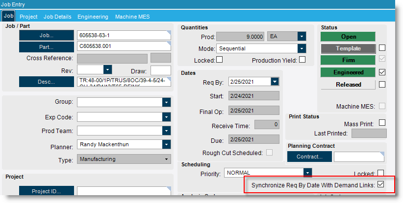

For this to work, the ‘Synchronize Req By Date with Demand Links’ box needs to be checked on the Job

I have uploaded the whole dashboard, with the 2 BAQs. Like I said it works perfectly for scheduling forward but not backwards.

Thanks for your reply. I tried ticking the box and running the global scheduling but the dates on the job did not change for some reason.
Adrian.
Hi @Matt,
this checkbox works ONLY if you make to order, i have tested it on make to stock in my environment and did not work, that is why we had to create a workflow in Service Connect to do this mass update task for us.

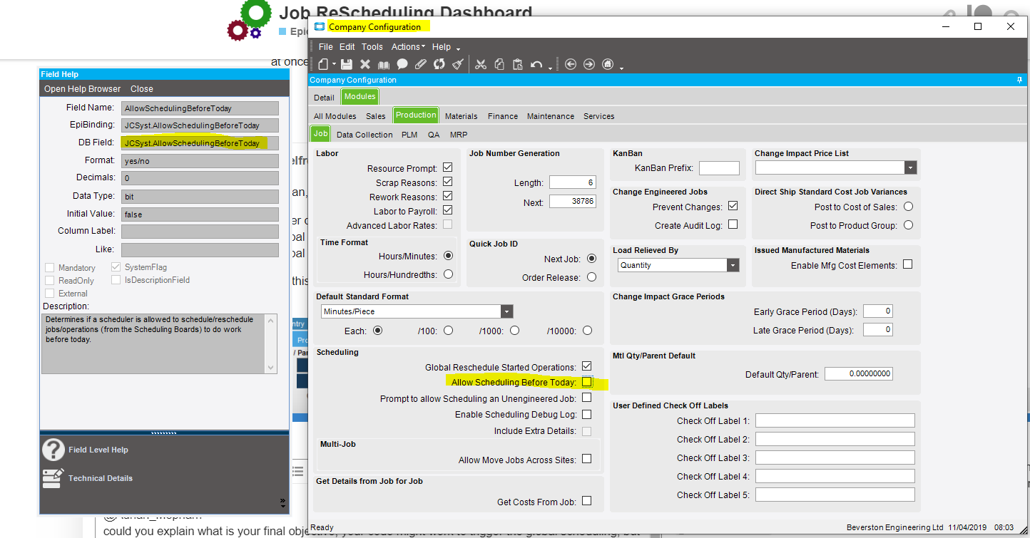

I don’t think we would ever want to reschedule jobs to before today but what we do a lot is reschedule order dates to the end of the year if we do not know the new required date. This takes the jobs out of various reports, MRP etc. The dashboard does this with no problem. When the customer contacts us to confirm delivery in 3 weeks for example, we can change the dates on the order but the dashboard will not reschedule the jobs backwards from the end of the year so we have to do them all individually.

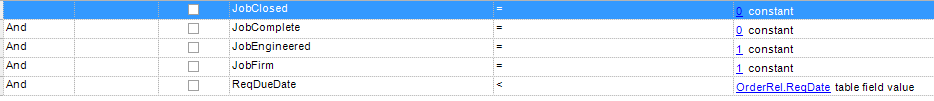

I managed to get it working on my machine by changing the < to <> in the criteria;
