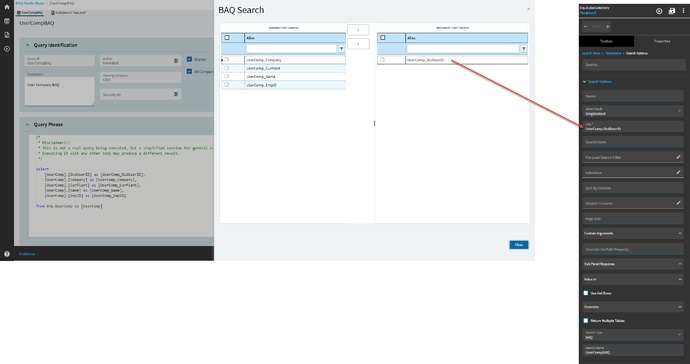

I am trying to create a search field that invokes the UserCompSearch. When I run the form, Epicor displays an error stating that the ERP.BO… does not exist or cannot be run.
Error:
I tried to create the search via a BAQ but am getting the same error message.
Please, Does anyone know how I can correct it?

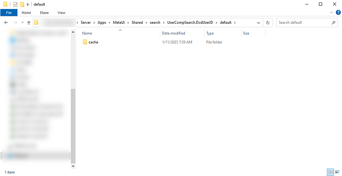

Well, it looks like UserCompSearch is missing, well, everything in the MetaUI folder.
Compared to UserFile

For your BAQ Search, you need to have the Like* column match what you have in your BAQ.
Do you know how to pass parameters to that BAQ?
