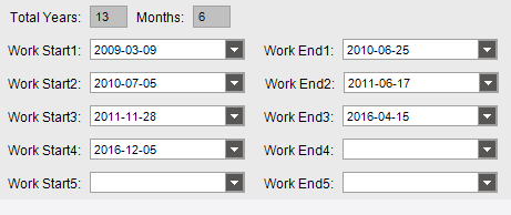

So far, we’ve been adding new UD fields to keep track of when an employee starts and when they stop working. Right now we have five EmpBasic_UD_Start_Date#_c and five EmpBasic_UD_End_Date#_c fields, but someone is about to start their 6th year.
For example, this is how part of the Employee Maintenance screen looks right now:
Adding N amount of UD fields is not ideal and we need a better solution.

  • We can use a UD table like UD03. I can add EmpID_c, WorkStart_c, and WorkEnd_c UD columns and dedicate the entire table to these dates. It seems like a waste of a table to store a list however.
  • I can create a really big nvarchar(10000) UD field for EmpBasic_UD and comma-separate the date ranges.
