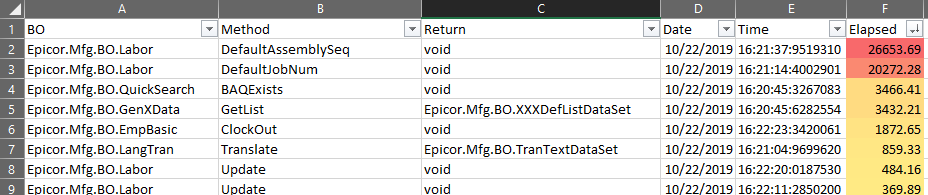

Here’s another run. I did this in MESC with base configuration. Job and Assembly both took 20+ seconds. There should be no customizations running in base, correct?
Epicor.Mfg.Lib.SessionMod Sync void 10/22/2019 16:20:43:7928013 PM 239.9181 Epicor.Mfg.BO.UserFile GetByID Epicor.Mfg.BO.UserFileDataSet 10/22/2019 16:20:44:0416968 PM 120.7237 Epicor.Mfg.BO.UserFile GetDefaults void 10/22/2019 16:20:44:1668583 PM 14.1808 Epicor.Mfg.BO.UserFile IsPasswordExpired bool 10/22/2019 16:20:44:1838144 PM 8.1627 Epicor.Mfg.Lib.SessionMod GetModuleAccess void 10/22/2019 16:20:44:2057898 PM 6.1589 Epicor.Mfg.Lib.SessionMod GetLicense void 10/22/2019 16:20:44:2137335 PM 8.9769 Epicor.Mfg.Lib.SessionMod GetLanguage string 10/22/2019 16:20:44:2227104 PM 7.224 Epicor.Mfg.BO.LangName GetByID Epicor.Mfg.BO.LangNameDataSet 10/22/2019 16:20:44:2406617 PM 14.9945 Epicor.Mfg.Sec.SecRights CheckExecutionRights void 10/22/2019 16:20:44:3224817 PM 12.9655 Epicor.Mfg.Sec.SecRights CheckExecutionRights void 10/22/2019 16:20:44:3394846 PM 11.9179 Epicor.Mfg.Sec.SecRights CheckExecutionRights void 10/22/2019 16:20:44:3524002 PM 8.977 Epicor.Mfg.Sec.SecRights CheckExecutionRights void 10/22/2019 16:20:44:3613772 PM 6.9824 Epicor.Mfg.BO.GenXData GetRows Epicor.Mfg.BO.GenXDataDataSet 10/22/2019 16:20:44:7438864 PM 11.9985 Epicor.Mfg.BO.GenXData GetVersion void 10/22/2019 16:20:45:3137073 PM 8.9775 Epicor.Mfg.BO.QuickSearch BAQExists void 10/22/2019 16:20:45:3267083 PM 3466.4122 Epicor.Mfg.BO.QuickSearch BAQExists void 10/22/2019 16:20:48:7931205 PM 10.7345 Epicor.Mfg.BO.QuickSearch BAQExists void 10/22/2019 16:20:48:8038550 PM 9.9721 Epicor.Mfg.BO.QuickSearch BAQExists void 10/22/2019 16:20:48:8138271 PM 9.9737 Epicor.Mfg.BO.GenXData GetVersion void 10/22/2019 16:20:48:8247976 PM 8.2182 Epicor.Mfg.BO.GenXData GetList Epicor.Mfg.BO.XXXDefListDataSet 10/22/2019 16:20:45:6282554 PM 3432.2116 Epicor.Mfg.Sec.SecRights CheckExecutionRights void 10/22/2019 16:20:49:1741291 PM 11.1926 Epicor.Mfg.BO.LangName GetList Epicor.Mfg.BO.LangNameListDataSet 10/22/2019 16:20:49:1871306 PM 70.8111 Epicor.Mfg.Sec.SecRights CheckExecutionRights void 10/22/2019 16:20:54:2579982 PM 193.5401 Epicor.Mfg.BO.DynamicQuery ExecuteByID System.Data.DataSet 10/22/2019 16:20:54:4674940 PM 24.9332 Epicor.Mfg.BO.GenXData GetVersion void 10/22/2019 16:20:54:4954571 PM 17.9502 Epicor.Mfg.BO.GenXData GetRows Epicor.Mfg.BO.GenXDataDataSet 10/22/2019 16:20:54:5134073 PM 283.2668 Epicor.Mfg.BO.GenXData GetVersion void 10/22/2019 16:20:54:8238152 PM 14.1792 Epicor.Mfg.BO.Favorite GetList Epicor.Mfg.BO.FavFolderListDataSet 10/22/2019 16:20:54:8527380 PM 265.8223 Epicor.Mfg.BO.EmpBasic GetRows Epicor.Mfg.BO.EmpBasicDataSet 10/22/2019 16:20:56:1621306 PM 99.0568 Epicor.Mfg.Lib.SessionMod SetUser void 10/22/2019 16:20:59:4608925 PM 36.1551 Epicor.Mfg.BO.UserFile GetByID Epicor.Mfg.BO.UserFileDataSet 10/22/2019 16:20:59:4970476 PM 63.038 Epicor.Mfg.BO.UserFile GetDefaults void 10/22/2019 16:20:59:5600856 PM 14.9656 Epicor.Mfg.BO.UserFile IsPasswordExpired bool 10/22/2019 16:20:59:5760398 PM 8.9281 Epicor.Mfg.BO.UserFile GetRows Epicor.Mfg.BO.UserFileDataSet 10/22/2019 16:20:59:5959373 PM 62.4674 Epicor.Mfg.BO.Menu GetRowsTranslated Epicor.Mfg.BO.MenuDataSet 10/22/2019 16:20:59:6703709 PM 59.8858 Epicor.Mfg.BO.Labor GetRows Epicor.Mfg.BO.LaborDataSet 10/22/2019 16:20:59:7372299 PM 29.4944 Epicor.Mfg.Lib.SessionMod GetLanguage string 10/22/2019 16:20:59:7906592 PM 6.1866 Epicor.Mfg.BO.LangName GetByID Epicor.Mfg.BO.LangNameDataSet 10/22/2019 16:20:59:7968458 PM 10.77 Epicor.Mfg.BO.GenXData GetList Epicor.Mfg.BO.XXXDefListDataSet 10/22/2019 16:20:59:8589287 PM 10.9957 Epicor.Mfg.BO.LangName GetList Epicor.Mfg.BO.LangNameListDataSet 10/22/2019 16:20:59:8728889 PM 89.5258 Epicor.Mfg.BO.EmpBasic CheckShift void 10/22/2019 16:21:04:6231154 PM 12.2345 Epicor.Mfg.BO.EmpBasic ClockIn void 10/22/2019 16:21:04:6589635 PM 108.3 Epicor.Mfg.BO.Labor GetRows Epicor.Mfg.BO.LaborDataSet 10/22/2019 16:21:04:7682618 PM 31.9454 Epicor.Mfg.BO.LangTran Translate Epicor.Mfg.BO.TranTextDataSet 10/22/2019 16:21:04:9699620 PM 859.3253 Epicor.Mfg.BO.Menu GetRowsTranslated Epicor.Mfg.BO.MenuDataSet 10/22/2019 16:21:08:1440549 PM 9.0622 Epicor.Mfg.Sec.SecRights CheckExecutionRights void 10/22/2019 16:21:08:1989395 PM 15.8288 Epicor.Mfg.Sec.SecRights CheckExecutionRights void 10/22/2019 16:21:08:2197032 PM 12.2473 Epicor.Mfg.Sec.SecRights CheckExecutionRights void 10/22/2019 16:21:08:2377033 PM 10.9679 Epicor.Mfg.Sec.SecRights CheckExecutionRights void 10/22/2019 16:21:08:2579489 PM 9.9649 Epicor.Mfg.Sec.SecRights CheckExecutionRights void 10/22/2019 16:21:08:2738614 PM 8.9764 Epicor.Mfg.Sec.SecRights CheckExecutionRights void 10/22/2019 16:21:08:2918456 PM 9.9773 Epicor.Mfg.BO.Labor GetList Epicor.Mfg.BO.LaborHedListDataSet 10/22/2019 16:21:08:5028245 PM 42.1838 Epicor.Mfg.BO.GenXData GetList Epicor.Mfg.BO.XXXDefListDataSet 10/22/2019 16:21:08:6347659 PM 12.9799 Epicor.Mfg.BO.LangName GetList Epicor.Mfg.BO.LangNameListDataSet 10/22/2019 16:21:08:6587090 PM 73.9098 Epicor.Mfg.BO.EmpBasic GetList Epicor.Mfg.BO.EmpBasicListDataSet 10/22/2019 16:21:12:4361305 PM 17.9539 Epicor.Mfg.BO.Labor GetList Epicor.Mfg.BO.LaborHedListDataSet 10/22/2019 16:21:12:4560866 PM 30.9076 Epicor.Mfg.BO.Labor GetByID Epicor.Mfg.BO.LaborDataSet 10/22/2019 16:21:12:4889892 PM 39.3257 Epicor.Mfg.BO.Labor StartActivity void 10/22/2019 16:21:12:5303136 PM 63.5361 Epicor.Mfg.BO.Labor DefaultJobNum void 10/22/2019 16:21:14:4002901 PM 20272.284 Epicor.Mfg.Lib.BOReader GetList System.Data.DataSet 10/22/2019 16:21:37:0761935 PM 47.1933 Epicor.Mfg.BO.Labor DefaultAssemblySeq void 10/22/2019 16:21:37:9519310 PM 26653.6947 Epicor.Mfg.Lib.BOReader GetList System.Data.DataSet 10/22/2019 16:22:06:9953224 PM 128.7116 Epicor.Mfg.BO.Labor DefaultOprSeq void 10/22/2019 16:22:08:0828777 PM 250.3581 Epicor.Mfg.BO.Labor CheckWarnings void 10/22/2019 16:22:11:1523754 PM 32.9108 Epicor.Mfg.BO.Labor CheckEmployeeActivity void 10/22/2019 16:22:11:1902730 PM 17.9529 Epicor.Mfg.BO.Labor CheckFirstArticleWarning void 10/22/2019 16:22:11:2102194 PM 32.9129 Epicor.Mfg.BO.Labor SetClockInAndDisplayTimeMES void 10/22/2019 16:22:11:2451263 PM 35.9072 Epicor.Mfg.BO.Labor Update void 10/22/2019 16:22:11:2850200 PM 369.8871 Epicor.Mfg.BO.Labor GetRows Epicor.Mfg.BO.LaborDataSet 10/22/2019 16:22:11:7694005 PM 99.7374 Epicor.Mfg.BO.Menu GetRowsTranslated Epicor.Mfg.BO.MenuDataSet 10/22/2019 16:22:14:8432105 PM 11.1375 Epicor.Mfg.Sec.SecRights CheckExecutionRights void 10/22/2019 16:22:14:8842680 PM 11.9672 Epicor.Mfg.BO.GenXData GetList Epicor.Mfg.BO.XXXDefListDataSet 10/22/2019 16:22:15:1020720 PM 30.9163 Epicor.Mfg.BO.LangName GetList Epicor.Mfg.BO.LangNameListDataSet 10/22/2019 16:22:15:1389719 PM 58.848 Epicor.Mfg.BO.EmpBasic GetList Epicor.Mfg.BO.EmpBasicListDataSet 10/22/2019 16:22:17:9819708 PM 64.8316 Epicor.Mfg.BO.Labor GetDetail Epicor.Mfg.BO.LaborDataSet 10/22/2019 16:22:18:0517826 PM 94.8559 Epicor.Mfg.BO.Labor EndActivity void 10/22/2019 16:22:18:1725649 PM 88.3346 Epicor.Mfg.BO.Labor CheckWarnings void 10/22/2019 16:22:19:8753862 PM 142.3603 Epicor.Mfg.BO.Labor Update void 10/22/2019 16:22:20:0187530 PM 484.1589 Epicor.Mfg.BO.Labor GetRows Epicor.Mfg.BO.LaborDataSet 10/22/2019 16:22:20:5856840 PM 103.6997 Epicor.Mfg.BO.EmpBasic ClockOut void 10/22/2019 16:22:23:3420061 PM 1872.6501 Epicor.Mfg.BO.Labor GetRows Epicor.Mfg.BO.LaborDataSet 10/22/2019 16:22:25:2154869 PM 25.9608 Epicor.Mfg.Lib.SessionMod GracefulShutdown void 10/22/2019 16:22:26:0740956 PM 10.9669Any thoughts on what BPM Business Objects would need to be looked at? Would it be Labor?
Yes. The image I pasted shows the BO and Method.
