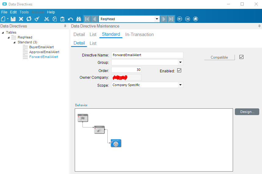

Create standard directives under ReqHead
We have three steps in our company.
Looking at your request, search for your ReqActionID and do the following
And set email template as this
I hope this helps!

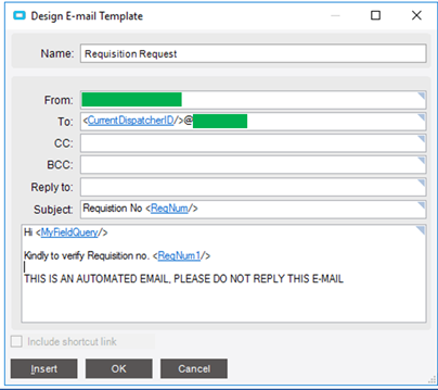

First, i had set a template email as below for asking verify PR from head department.

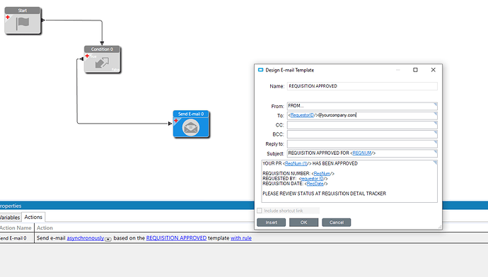

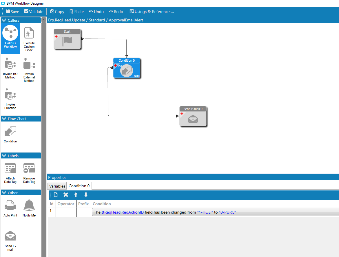

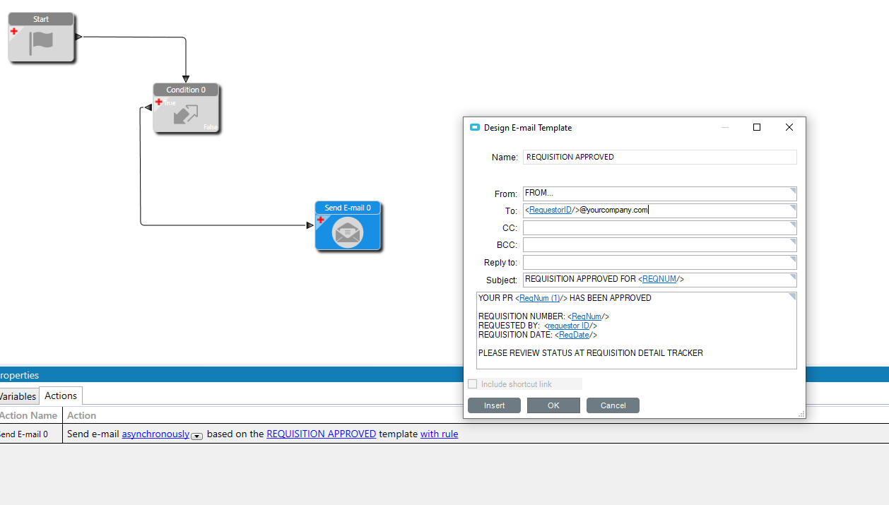

Then, how i can set a condition if PR done approved, then the purchaser will get a email notification about PR status. I mean another email notification for purchaser.
Hi Anis,
Again, same thing.
Create a standard directive at ReqHead.
You can put conditions as ReActionID changed from any to Approved/A and then send email notification.
