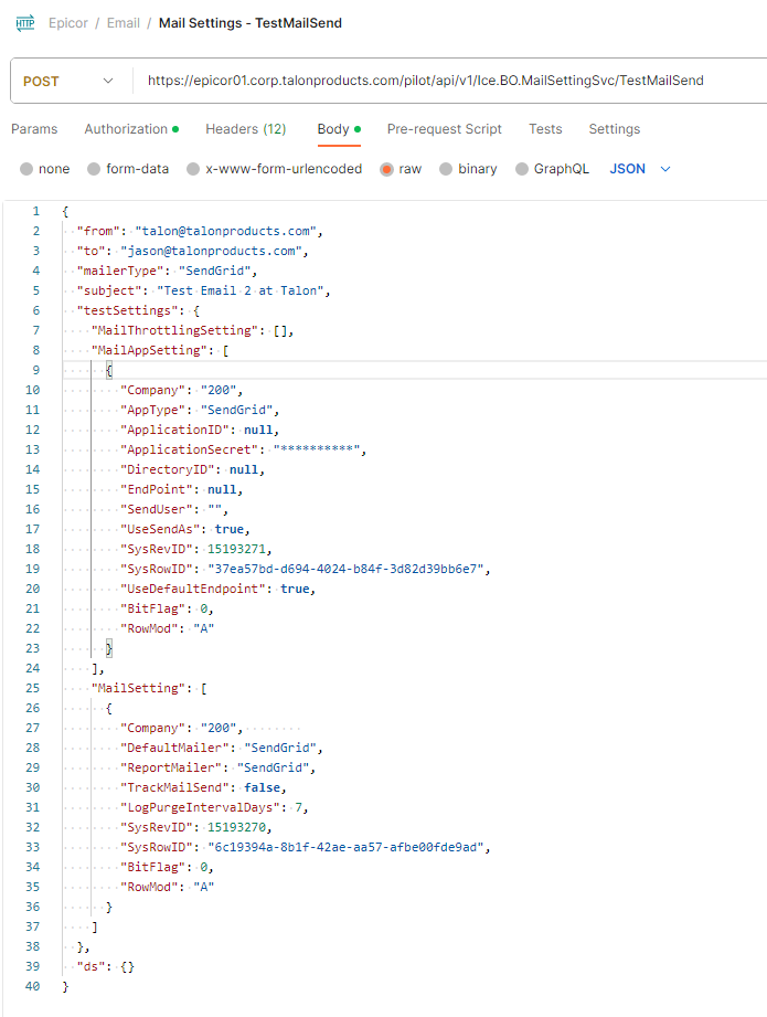

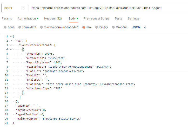

I’d like to override the from address in the SalesOrderAck email. I can successfully call the request below which sends an email with the sales order ack attached. However it only uses the “default from email field” in Mail Settings Maintenance. Epicor support says it isn’t possible and that it’s a SendGrid issue. Their claim seems inaccurate because in the second screenshot below I’m able to specify the from address in the TestMailSend function which is used in Mail Settings Maintenance.
Maybe it isn’t possible to include FROM ADDRESS in SubmitToAgent, but to me it’s simply because Epicor dev hasn’t included that attribute.

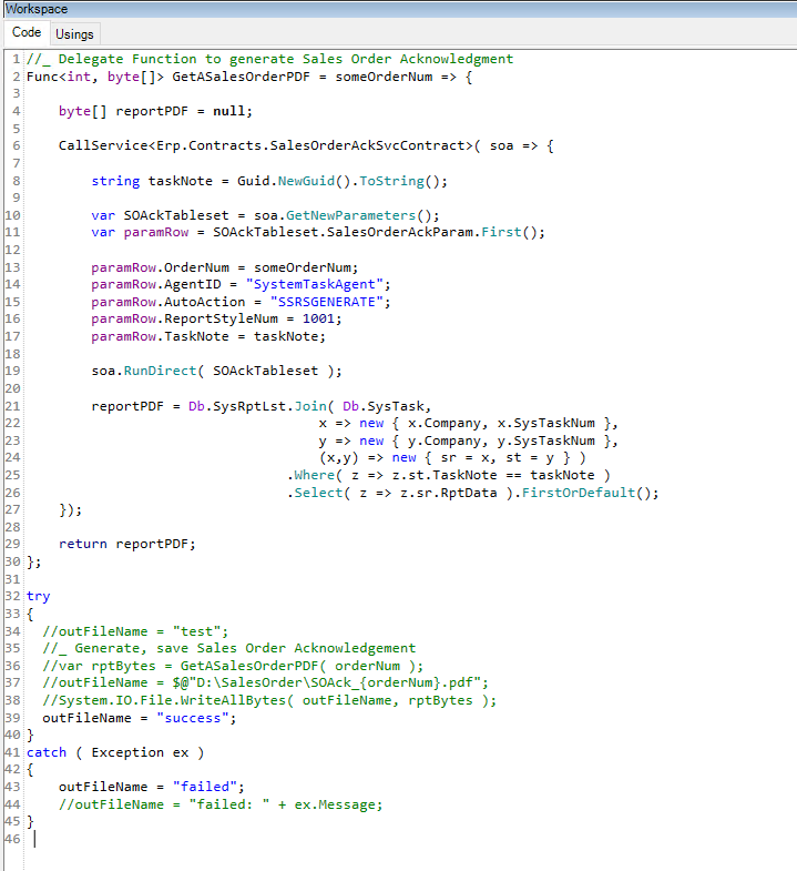

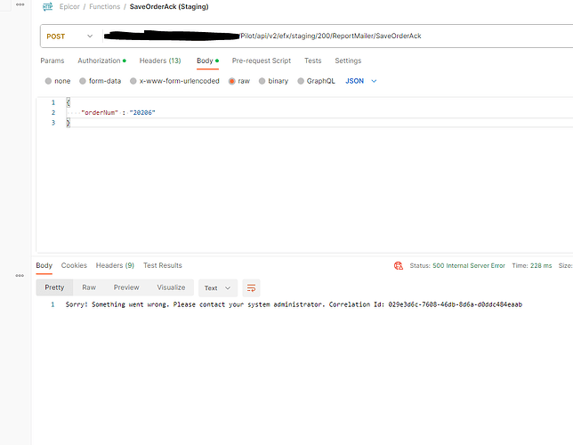

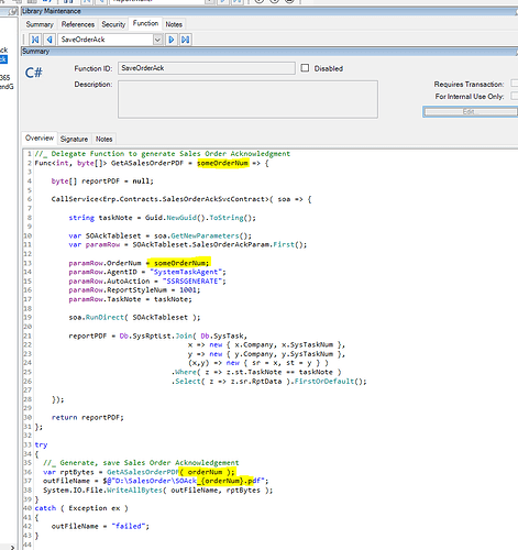

I have the SendEmail code/function working but need some assistance with the SaveOrderAck function. I’ve only narrowed it down to somewhere in the GetASalesOrderPDF function. The only value I’ve modified is “ReportStyleNum = 1001”. Anything else obvious that I’m missing?
Okay I just re-tested this, looks like I had the “Required Transaction” checkbox checked on the SaveOrderAck function. Not sure why I checked that, I don’t have it checked in my production version. Try unchecking that box on the function.
Ok Kevin I’m getting some odd behavior on this. Looks like it’s related to the Epicor user that’s logged in.
When I run the code from the screenshot it processes correctly.
When another user runs the code the ordernum param is correct, the PDF file name is correct (and eventually attached to the email), but the actual report rendered within the PDF is of the wrong sales order. It’s actually always the same order, no matter which ordernum we send in to the function. Is this somehow related to permissions when calling soa.RunDirect() ? Or is this an issue with the Db.SysRptLst.Join code?
