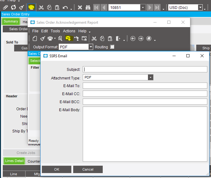

BPM Method on SSRS Email (print) a Sales Order?
When our users are done entering a sales order they want to send a order acknowledgement via email. We want to use the standard SSRS email option under the Print menu (see screen shot) but pre-filled in Subject, To, and email Body.
I’ve done a trace but the method it shows can’t be found. Any ideas where to look?
Trace snip:
< tracePacket >
< businessObject>Erp.Proxy.Rpt.SalesOrderAckImpl< /businessObject>
< methodName>SubmitToAgent< /methodName>
Screen shot:

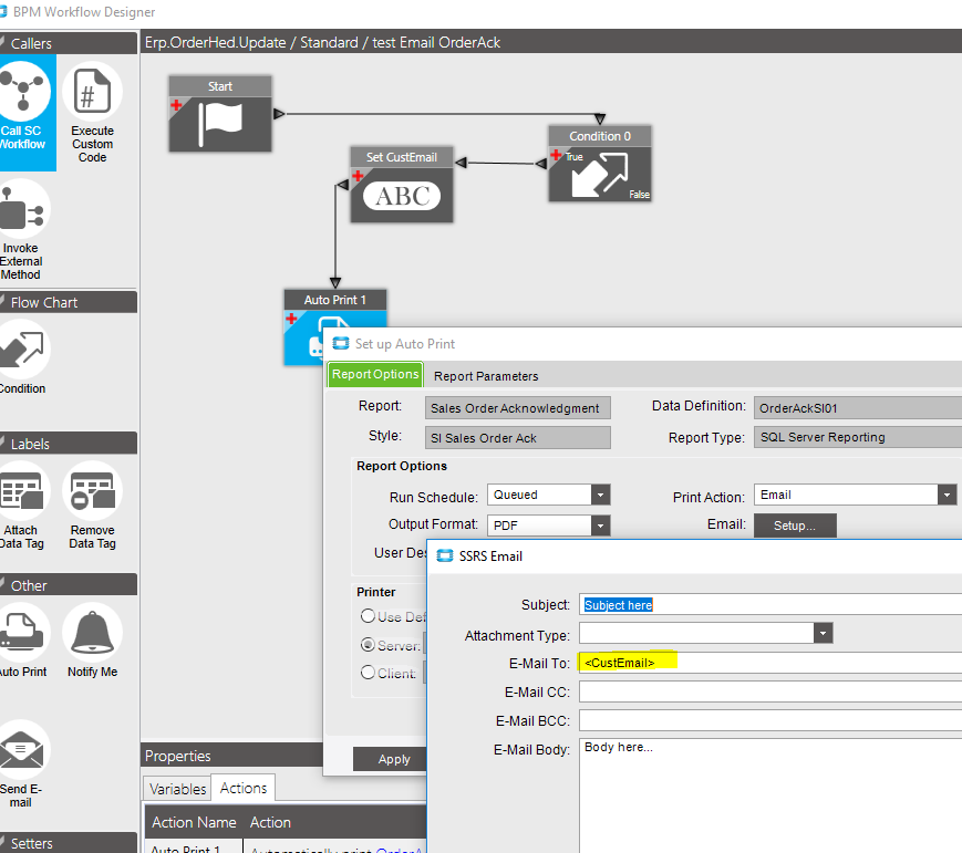

Was trying another route of using AutoPrint. Can variables be referenced in a auto print email message? I get an error when I try to use the variable I have setup for the customer’s email address.

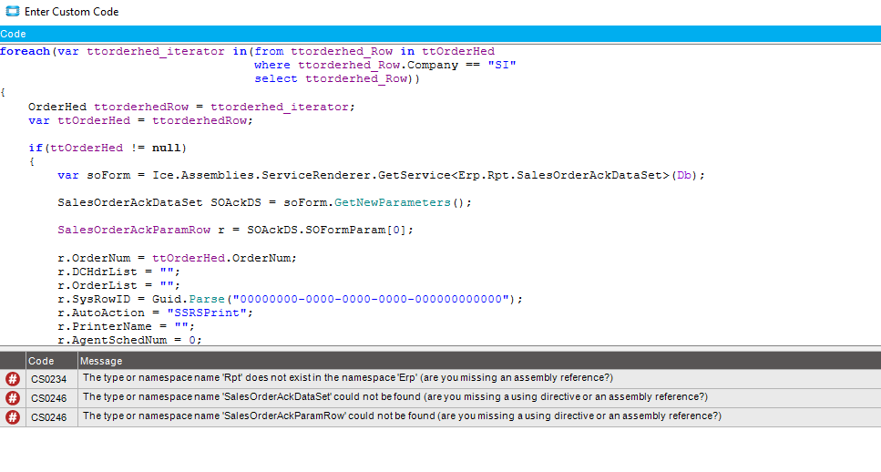

Ok, I’m close. Just a few error I can’t seem to figure out. Looks like an assembly but I’m not sure how to add it or what it is. Running a new trace log to see if it’ll help.
This is BPM so you should use TableSets not DataSets look at my Example
Also your GetService should be
GetService<Erp.Contracts.SalesOrderAckSvcContract>(Db)
Thanks for the correction. Guess I pulled too much out of the tracelog as I got both from the trace. Still missing something, I think it’s a reference but I’ve added the ones I think it’d need, am I missing some?
System.Drawing.Bitmap CS0246 The type or namespace name ‘SalesOrderAckTableSet’ could not be found (are you missing a using directive or an assembly reference?)
System.Drawing.Bitmap CS0246 The type or namespace name ‘SOFormParamRow’ could not be found (are you missing a using directive or an assembly reference?)

You’ll need to add the right using statement
using Erp.Tablesets;
And it should be SalesOrderAckParamRow

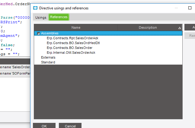

Make sure the Assemblies has Erp.Contracts.Rpt.SalesOrderAck
