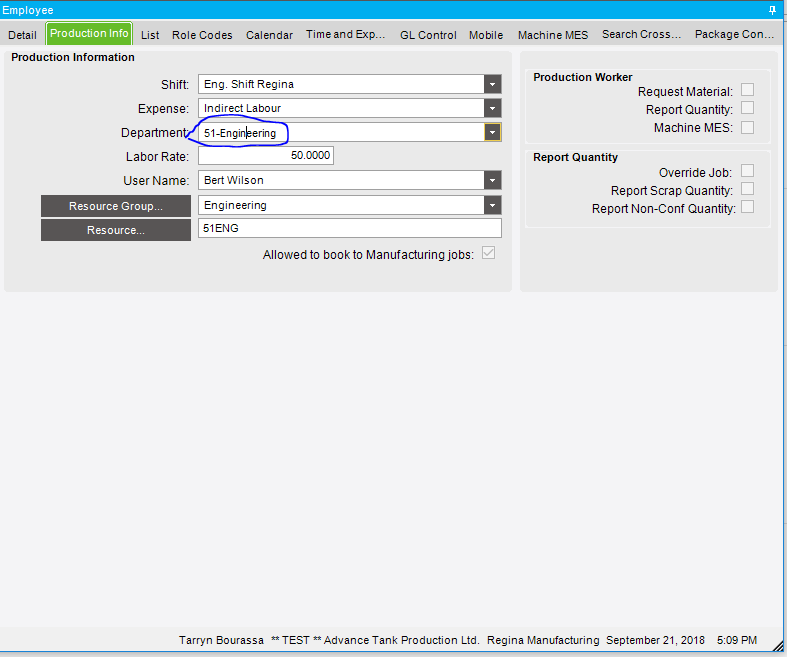

Screenshots below of current setup. Both need to be costed to the job but we need to see the expense separately.
Production Worker:
Engineer:
Ok, these two screens look to be pointed to the same indirect labor account. You could separate them by creating a GL code for the job department and tie that to a Eng GL department code.
That would let you use the same chart number for both types of labor but show the separation at the dept level.
Is that what you are looking for?
Brad

Still not doing what Finance needs as it is still following the COGS. Here is a full explanation from them:
EngTime02
This is the employee to the job department level of GL Control and Codes.
This is the WIP report: 1.5hours of time at $50.00
This is the path the system is defaulting to for WIP and Inventory transactions.
