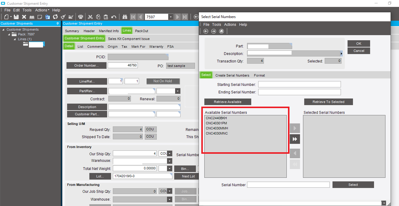

Hi,
In shipment entry against one lot number ,that serial need to show . how to get that. any one have some idea, let me know
Is that SN in that lot?
Epicor uses current SN information and the transaction table to populate the SN on the Available Serial Numbers list.
Ya.
serial number having only 2 for that lot #, other serial no. having in other lots.
Multiple lot serial number showing . need to show one lot against serial number in that .
give some idea how to popup same lot against serial number.,
I would look at the SNTran table. See if there are transaction for the good one (SN that are on the list) that are not on the transaction list of the orphan on (SN that should be on the list)
Hi Ken,
Serial number having transaction list . But while clicking serial number button based on lot number against serial need to show
What are the transaction of a good SN vs the orphan one?
Are the transaction types identical?
The more you can share about the transaction the easier it is for us to help.
