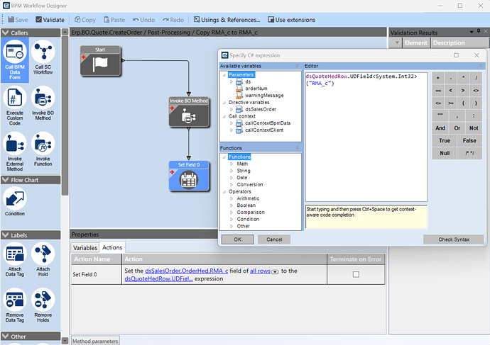

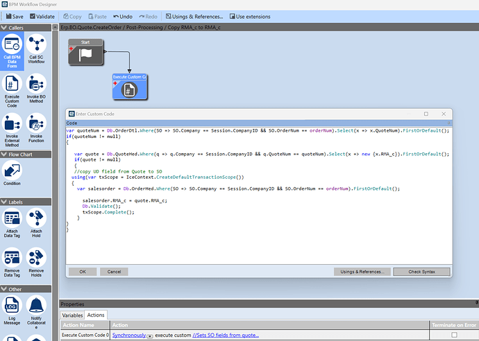

I have created a post process for Erp.BO.Quote.CreateOrder to copy over a UD field from the QuoteHed to the newly created OrderHed.
I have accomplished this two different ways and both ways have Validated successfully in the BPM Workflow Designer. However, when I go to save the BPM, I receive a Server Side Error. The error is the same for either of the two Post Processing methods that I have created. I am a bit perplexed and I am not sure what I have missed.

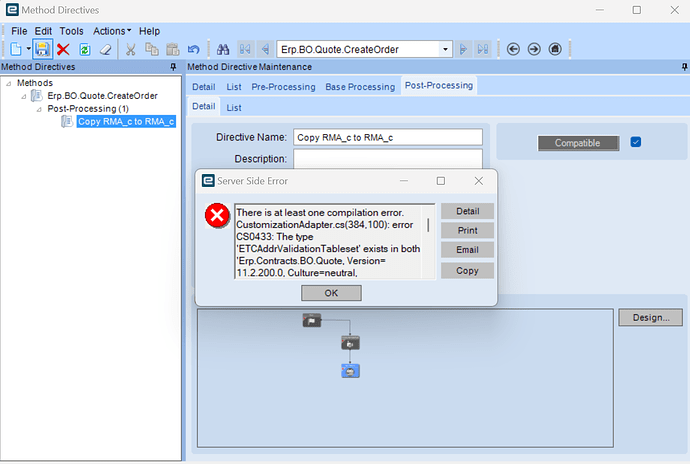

Here is the full detail of the error message.
Server Side Exception
There is at least one compilation error.
CustomizationAdapter.cs(384,100): error CS0433: The type 'ETCAddrValidationTableset' exists in both 'Erp.Contracts.BO.Quote, Version=11.2.200.0, Culture=neutral, PublicKeyToken=5d3fa3c7105d7992' and 'Erp.Contracts.BO.SalesOrder, Version=11.2.200.0, Culture=neutral, PublicKeyToken=5d3fa3c7105d7992'
CustomizationAdapter.cs(389,30): error CS0433: The type 'ETCAddrValidationTableset' exists in both 'Erp.Contracts.BO.Quote, Version=11.2.200.0, Culture=neutral, PublicKeyToken=5d3fa3c7105d7992' and 'Erp.Contracts.BO.SalesOrder, Version=11.2.200.0, Culture=neutral, PublicKeyToken=5d3fa3c7105d7992'
CustomizationAdapter.cs(9,132): error CS0738: 'QuoteSvcCustomization' does not implement interface member 'QuoteSvcContract.ETCValidateAddress(int, int, out bool, out bool, out string)'. 'QuoteSvcCustomization.ETCValidateAddress(int, int, out bool, out bool, out string)' cannot implement 'QuoteSvcContract.ETCValidateAddress(int, int, out bool, out bool, out string)' because it does not have the matching return type of 'ETCAddrValidationTableset'.
CustomizationAdapter.cs(9,132): error CS0535: 'QuoteSvcCustomization' does not implement interface member 'QuoteSvcContract.ETCAfterAddressValidationOTS(ref QuoteTableset, ETCAddrValidationTableset, int)'
CreateOrder.CommonTypes.cs(167,55): error CS0433: The type 'QuoteQtyRow' exists in both 'Erp.Contracts.BO.Quote, Version=11.2.200.0, Culture=neutral, PublicKeyToken=5d3fa3c7105d7992' and 'Erp.Contracts.BO.SalesOrder, Version=11.2.200.0, Culture=neutral, PublicKeyToken=5d3fa3c7105d7992'
Error Detail
Correlation ID: 052aa19c-8fa8-4697-b36e-d830b48ca45d
Description: There is at least one compilation error.
Details:
