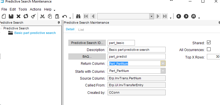

I’m going to revive this zombie thread. I read the manual on predictive searches and I appear to be doing everything right.
The error I mention occurs when I try to save a predictive search setup.
What does the BAQ look like? Also have you tried increasing the BAQ timeout period? What’s yours set to?
The BAQ is a simple part query. Part Table->Part Number.
I’ve never seen the BAQ timeout - where is that? But why doesn’t it timeout in the BAQ writer?

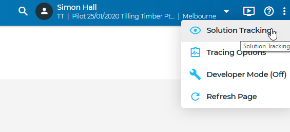

@Hally where to find Open Track Solutions. I am getting same error cannot save predictive search.
image for Active home page
or
Solution tracking also exists in your General Options:
In the modern shell you can see if you are tracking a solution as it shows in the status bar at the bottom of the page.
Hope that information helps.
