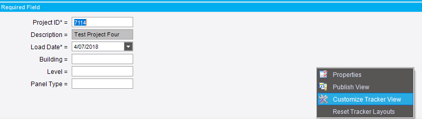

I have a dashboard with a tracker input prompt for a date field.
Is there anyway I can have that field default to today’s date when the dashboard loads?
And preferably, the value is applied prior to the Auto Refresh on Load of the dashboard.

I think I can answer the question:
And then in the InitializeCustomCode(), set the value for the control to DateTime.Today
public static void InitializeCustomCode()
	dteCalculated_LoadDate.Value = DateTime.Today;
For the other question, I guess you can take the condition out of the BAQ, and use the Trackview data as the filter instead.

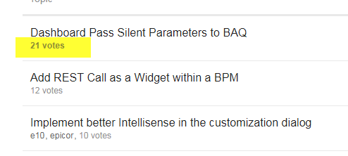

Not without coding the BAQ. Go vote for this one. We all want it!
I VOTED!!!
And its the clear winner of desired features
I wonder how many it will take for Epicor to put it on a priority list? 21 doesn’t seem like enough. :frowning_face:

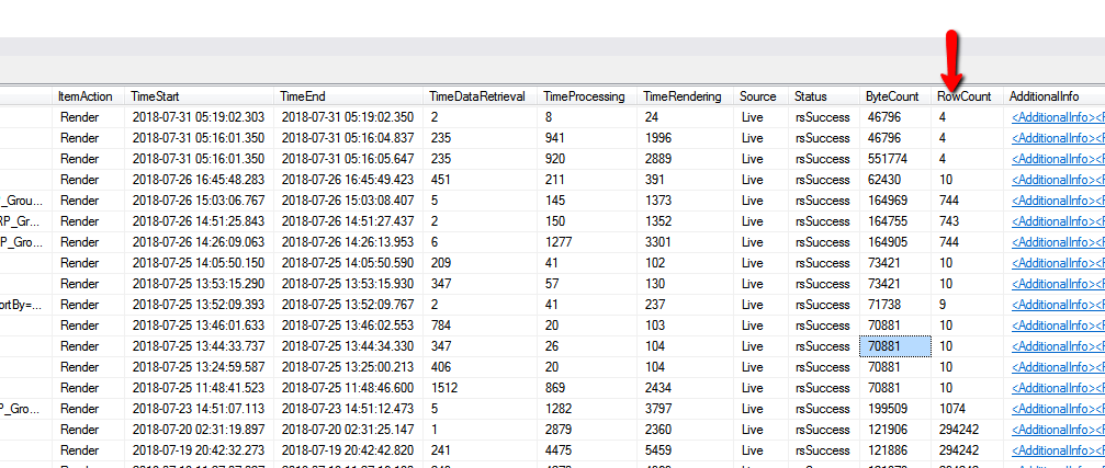

Maybe while they do this fix same goes for “BAQ Reports” that despite having Filters it runs the BAQ “Widely” open and only applies your filters POST-Query.
You end up with 1000+ Rows but the SSRS only shows 1 or 10. Problem: BAQRpt filters POST Query.
That depends on when you want it filtered though. Depending on your BAQ, if you are aggregating, you need to be able to specify whether or not you want pre or post filtering.

Hi @ckrusen
i do not know if this idea will help you on this requirement, but why don’t you create dataview field on your dashboard tracker and bind it to CallContextVariable, then use this variable as a constant value criteria in your BAQ, using this syntax [EpiBinding:BPMData.XXXXX],
This works great, thank you!
