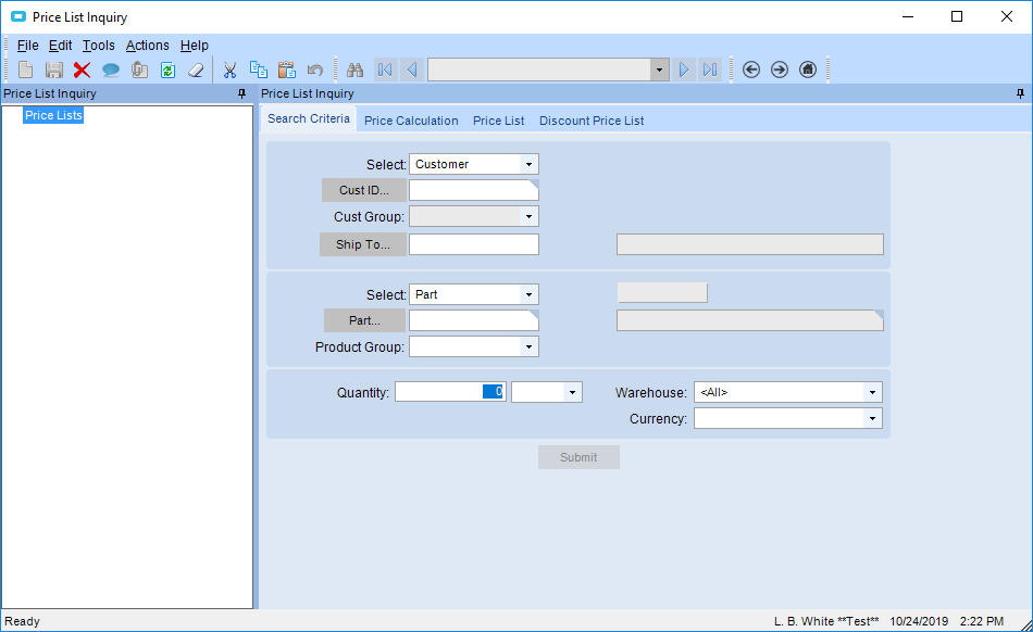

This feels like it should be easier to me. I’m trying to set the default qty to 1. I’ve tried changing the value but it doesn’t stay. Have also set the value when the form loads but that doesn’t work either.
What’s the right way to do this?
