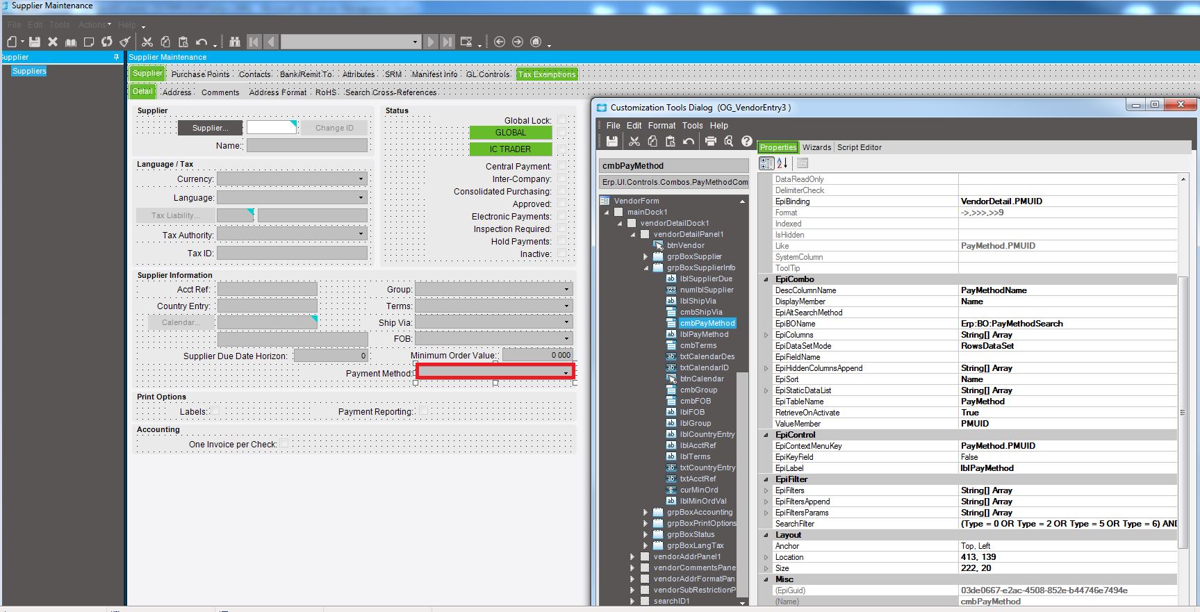

Whenever a new supplier is created, I’d like to have the “Payment Method” field default to “Check.”
I’ve been unsuccessful with the customization of getting the field to display “Check.” What I have so far is below, but doesn’t work.
Any help or suggestions would be appreciated.
Thanks in advance.
Billy

The code doesn’t change the field to “Check,” but rathers just stays “Non-Selected”

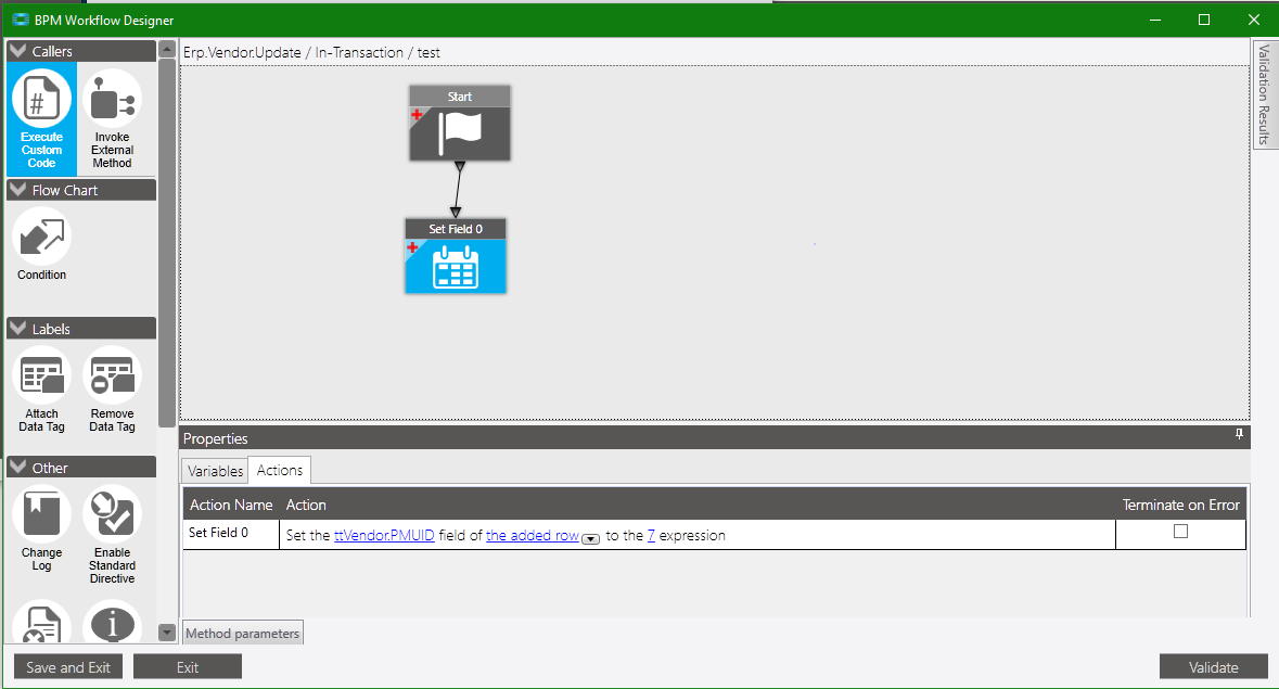

I know your question was about a screen customization but, you could do it with a Data BPM, anytime a record is added to the Vendor table make Vendor.PMUID = 5?

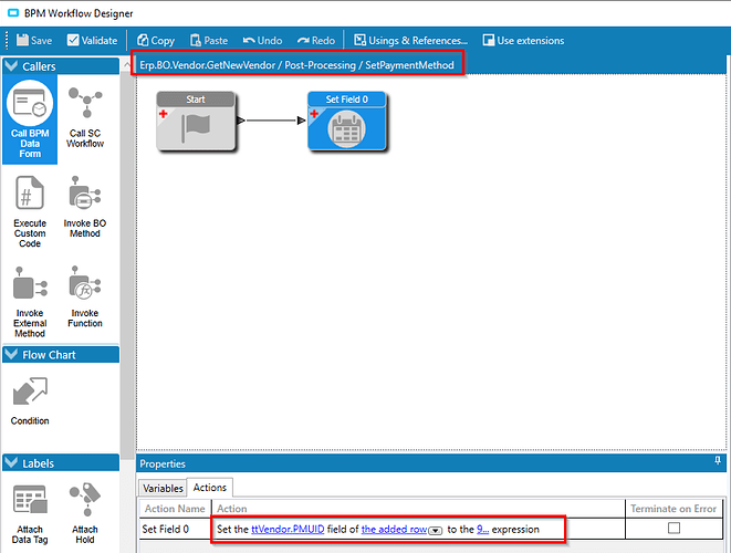

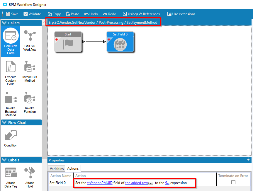

All you need for this is a simple BPM on GetNewVendor:
Replace 9 with whatever your ID is.
