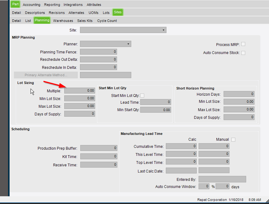

Are they 3 of the same part? Would lot sizing work for that? I don’t use it, so I’m not sure it’s the right answer, but you could check it out.
