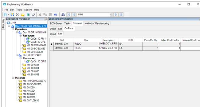

First of all, you need to have the Advanced Production module to use the Co-Parts functionality.
In the Engineering Workbench, there is a Co Parts tab beneath the Revision tab where you define the additional parts created when you create the “main” part (you get to choose which one is which).
Basically it’s the same engineering process as a single part, it’s just that 2 (or more) output parts are created for the same materials and operations. If you sell your parts separately on different sales order lines, then your job would have two demand links, one for the left part and one for the right part. The job itself will show a production quantity for the SUM of the 2 requirements.
Epicor has a co-part functionality… you create the BOM for Part1-Right, and specify that you will get Part1-Left at the same time. You can also define the percentage of cost that goes to the co-part in case it should get a different percentage.
Then you sell both Part1-Right and Part1-Left, and the system will work.
In situations where sales for the Right and Left vary (one being bigger than the other sometimes) you can also create a BOM for Part1-Left, and specify the Part1-Right as a co-part… this way, if you need more lefts than rights, you will get a job to make the left parts.
There are some situations where you make parts by the SHEET full… You can get 10 part1s from the sheet, and also get 2 part2s as a copart… but when you need more part 2s, you may have the bom designed to get 6 part 2s, and only 1 part1 as a copart.
My do-nut example works here… When you roll out your donuts, you get 12 round donuts, and 30 donuts + 32 donut holes (the holes between the donuts and the holes from the inside of the donut). So an order job of 12 donuts gives you 30 holes as a copart… but you could simply cut 80 holes and skip the donuts. This way, if you have a large order of donut holes, the system will make the Holes instead of the donuts.

Now you have everything you need to create the method. Use part A’s part number for the part (you will add Part B’s part number in the co-parts area later). Add your operation with a Prod Std of the PPH you calculated for both parts (100). When adding the resin as a material, use the full shot weight of 40 grams (enough for both parts plus the runner) as the Qty/Parent.
Go to the Revision > Co Parts tab and click new. Add your child part (in our example Part B). I then click on the List view so I can see both parts. For the parent part A, change the Material Cost Factor to the percentage you calculated earlier (in our example it was 40). Leave everything else the same as it appears. Make sure the Primary Costing Method is checked. For the child part, add the percentage you calculated for part B (our example, 60). Check the Prevent Suggestions checkbox.
Check it in and you should be good.

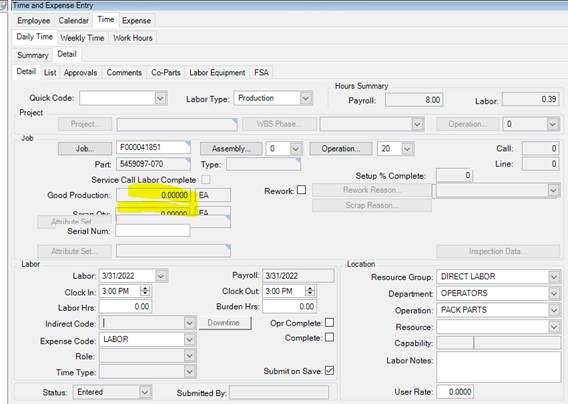

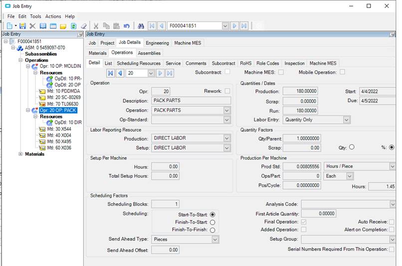

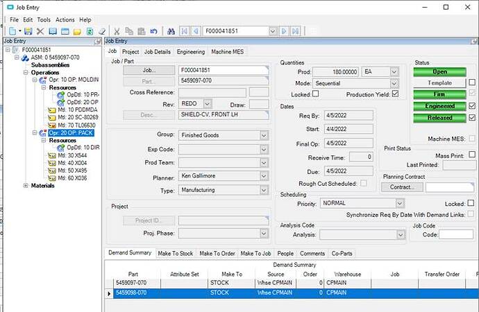

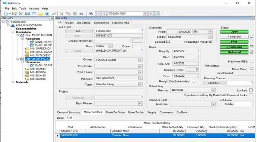

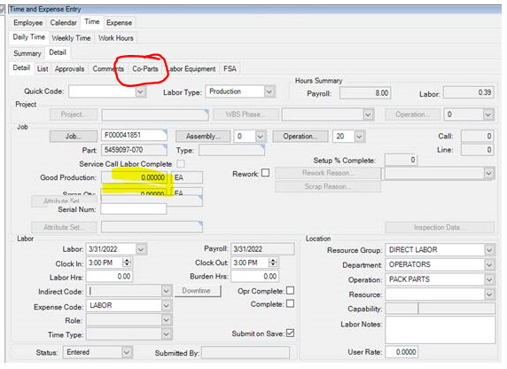

My method has been completed and I released a job but am confused when I went to report against it.
I am unable to report against the 2nd operation of Pack and I also don’t see how my quantity complete for the second part can be recorded. Highlighted areas greyed out

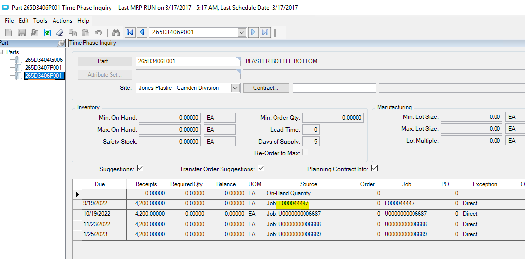

I am also confused as to why the same job number is showing for both parts in Time Phase and I see the demand for both on the job just not seeing quantity complete for the copart. I set this up for 2 parts made in the same mold but the will be received to stock as separate parts and will get label and boxed as such. To do that they need to show parts completed against them individually. Did I miss something in my steps

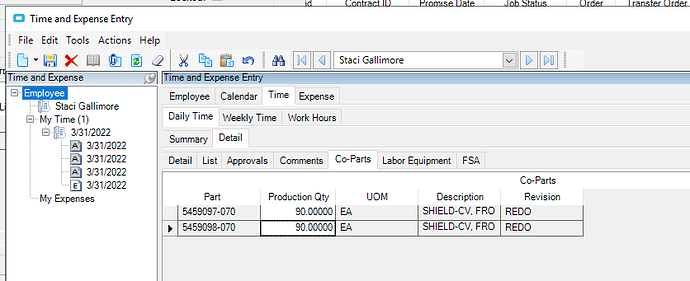

Hi Jeanne,
You need to go to the Co-Parts tab in Time and Expense Entry to report the quantities for the 2nd operation:
When you get to that tab, you will see an area for reporting the quantity of each part.
Try that and I think it will clear up some of the confusion. You should be able to receive them to stock from the job as individual parts.

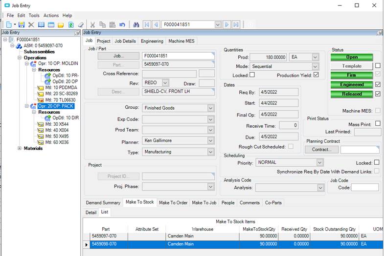

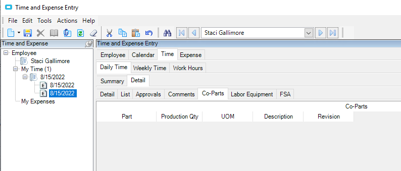

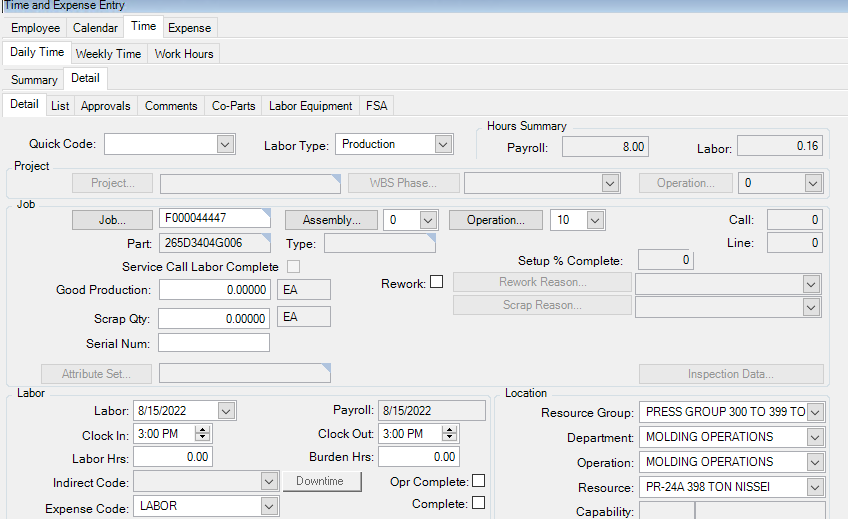

Its been a while but your my go to source for Co parts…lol Needless to say my great example that I had worked all the way thru is missing in action as they copied over our test Database. I thought my memory was good but I ran into an issue. My Co parts are showing correctly in time phase but when I firmed up one of the jobs its not showing the two parts being made and in time and expense I am unable to report against the two parts qty complete. I think I have missed a step. here are my screen shots.
Any clue you can give me where to look would be appreciated
Jeanne

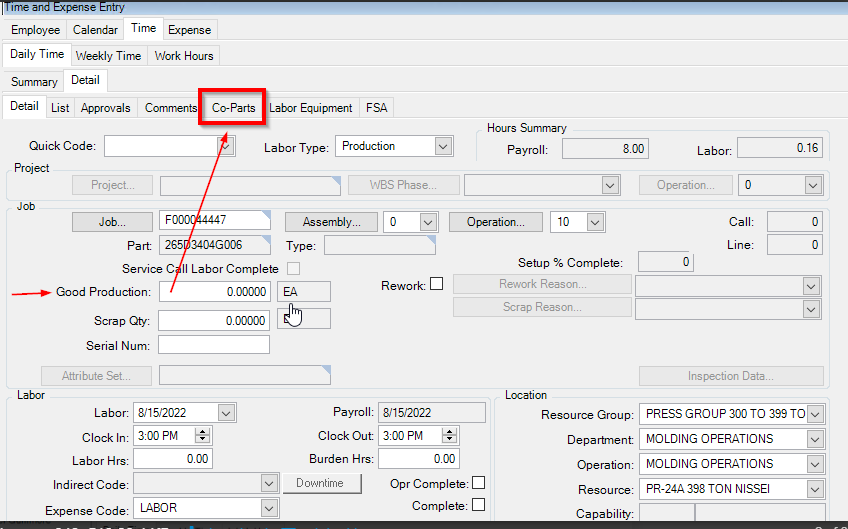

Hi Jeanne,
Did you try reporting quantity on the Co-Parts tab instead of the Detail tab:
Try that and let me know. That should make it work!

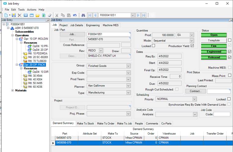

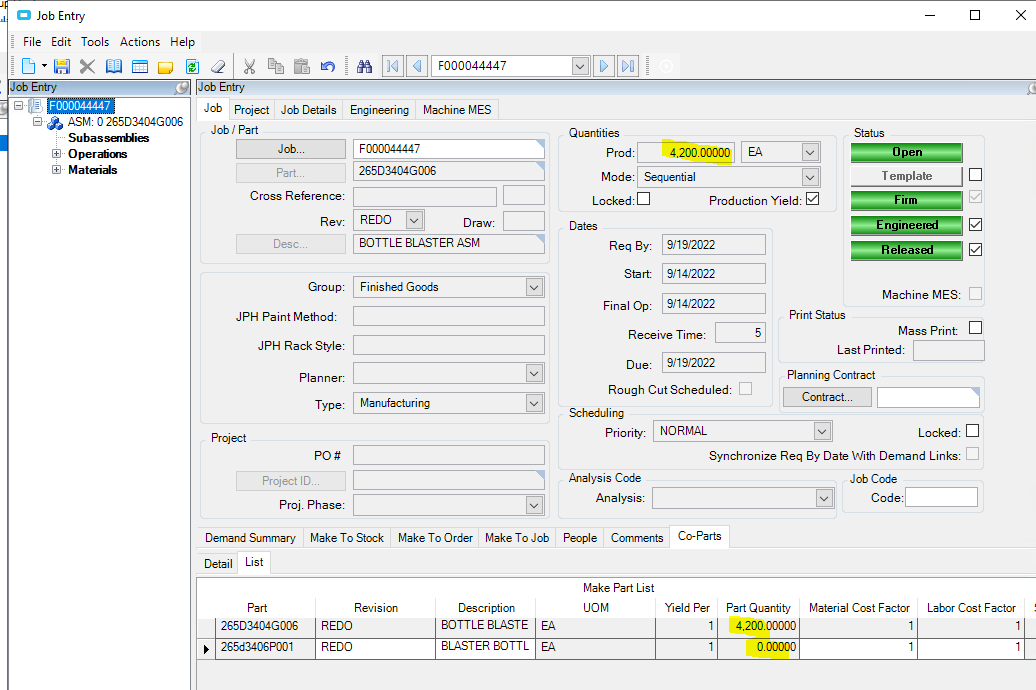

Yes the tab came up blank and did not allow reporting. Plus shouldn’t this show quantity’s on both lines. Like the screen shot below it

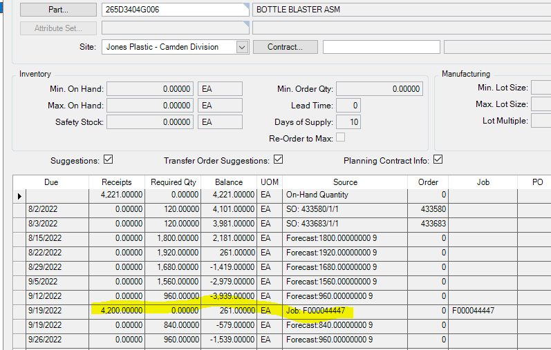

I need 4200 of each part that is coming out of the dual cavity mold
My planning looks great as I need 4200 of each part So I am assuming I should see each part showing a quantity of 4200 on my demand lines
First shot is the parent 2nd is the child
