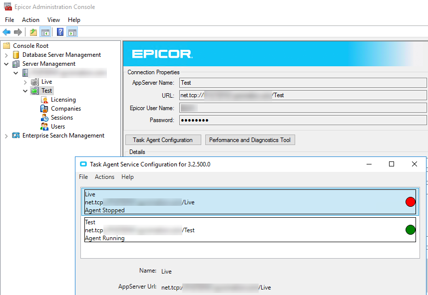

Shut down and restart the task agent. It always fixed it for us.
120GB used of 128GB available.
@dpenn I have restarted the task agent for the new application pool to no avail
