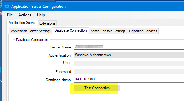

If you go into EAC, launch the App Server Configuration, go to the Database tab, and Test Connection, do you get an error?
Yes, I tested, it didn’t work
Can you remote into the SQL server and connect to the production DB via SSMS, using the credentials specified in the App Server Config?
Yes, I can rdp and lauch ssms connect to the DB. Thank you very much Calvin.
