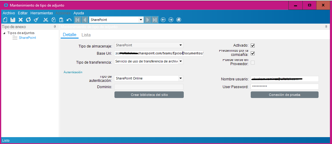

HI Mark, can you tell me how is your configuration on Epicor?

thanks everybody, we found the answer ourself
And?
Here Configuration on epicor:
