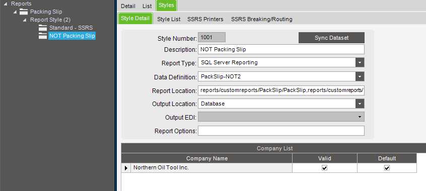

PackSlip Report Style looks like this
i assume the second half of the report location is whats pointing it to my copy of the label report. which works but im having trupble getting the new field to the report…

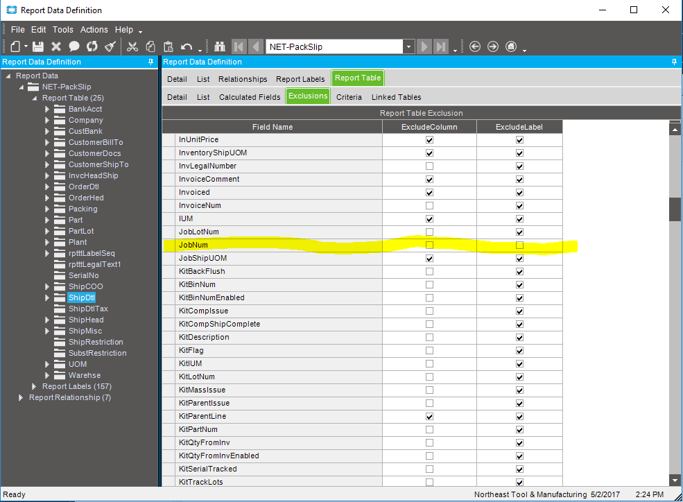

Okay great! that makes a lot of things easier for me then. What you need to do is go to the report data definition for your customized packingslip. so, my customized RDD is NET-Packslip. Expand the tree on the left hand side, expand the report tables, and in the tree view, select the “ShipDtl” table. On the tabs in the form, go to “Report table” > “Exclusions”. Scroll down until you see the JobNum field, and uncheck the boxes.
Save that, and try printing the report again. IF you did everything correctly, then it should now show up, if not, then I need to look into the SQL of how you called it.

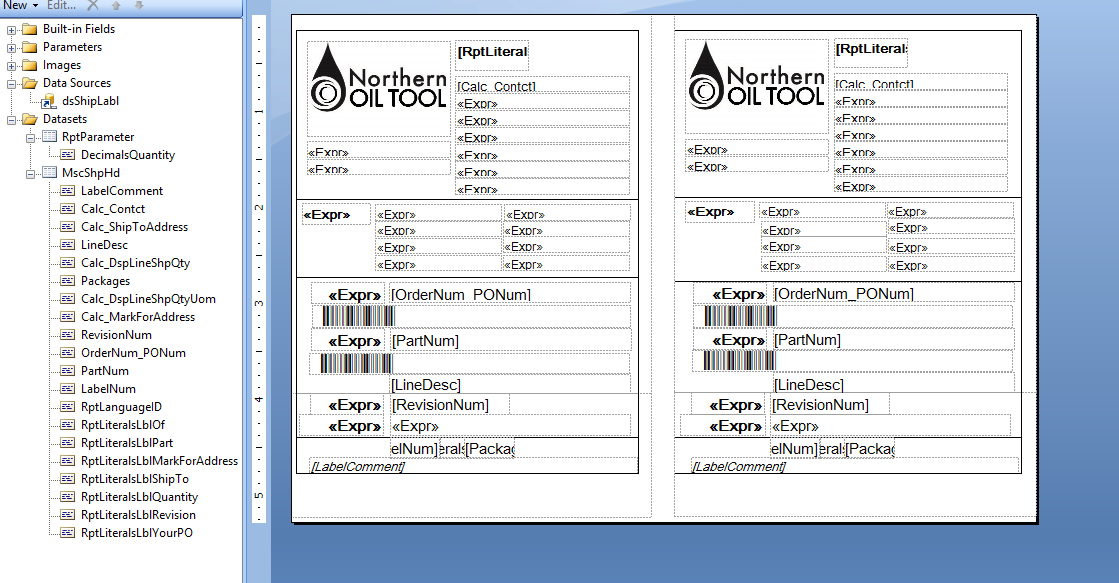

here is original that works but has no jobnumber
i added this in the copy (shiplabl1 is the new report name in ssrs)
i added T1.JobNum in the SQL
and field JobNum JobNum in the fields.
but if i run this report it dies… (by changing in Report Style the ShipLabl to ShipLabl1)
Change it to T2.JobNum in the SQL.
T2 is the ShipDtl table where the JobNum lives. You currently have it on the ShipHead table.
Dang it you beat me to it! That is the issue. T2.JobNum, not T1.JobNum
