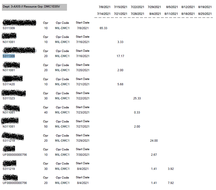

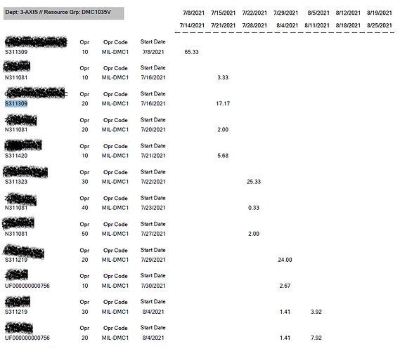

I also notice these are operations that have SetUp Time. The ones without SetUp Time seem to match up with the report nicely. Any idea what might contribute to the discrepancy?

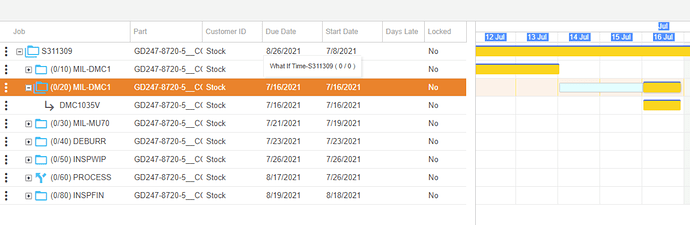

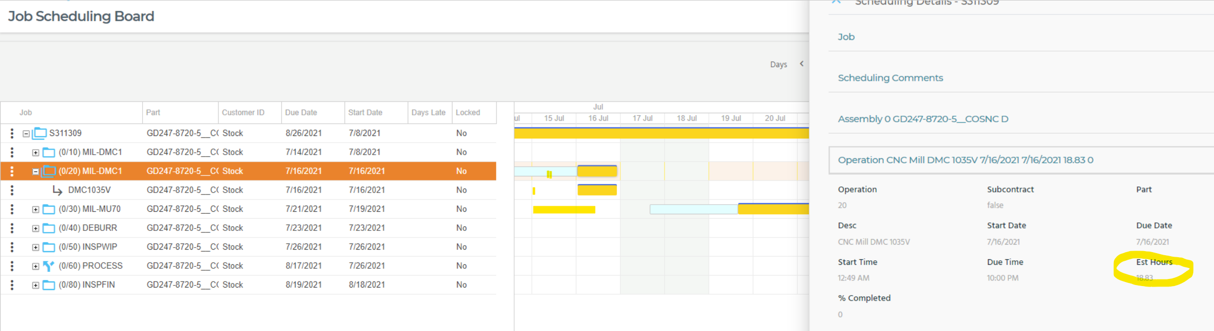

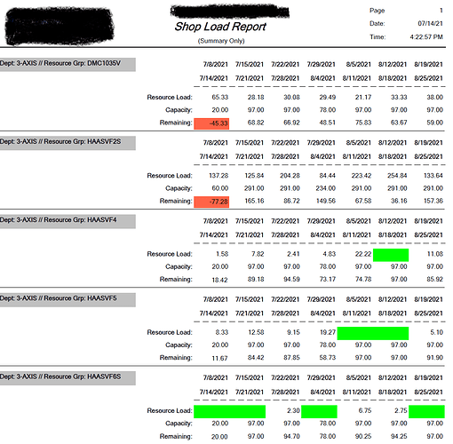

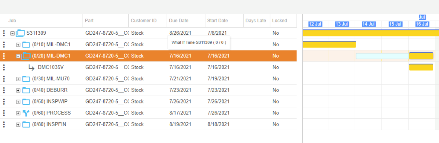

Can you look at Job Scheduling Board for the job in question and see if there is a chance that the setup time actually starts in the prior period? I must admit, this is worrying to me, as we rely heavily on the Shop Load report for long range planning.

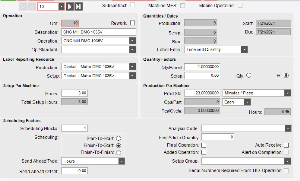

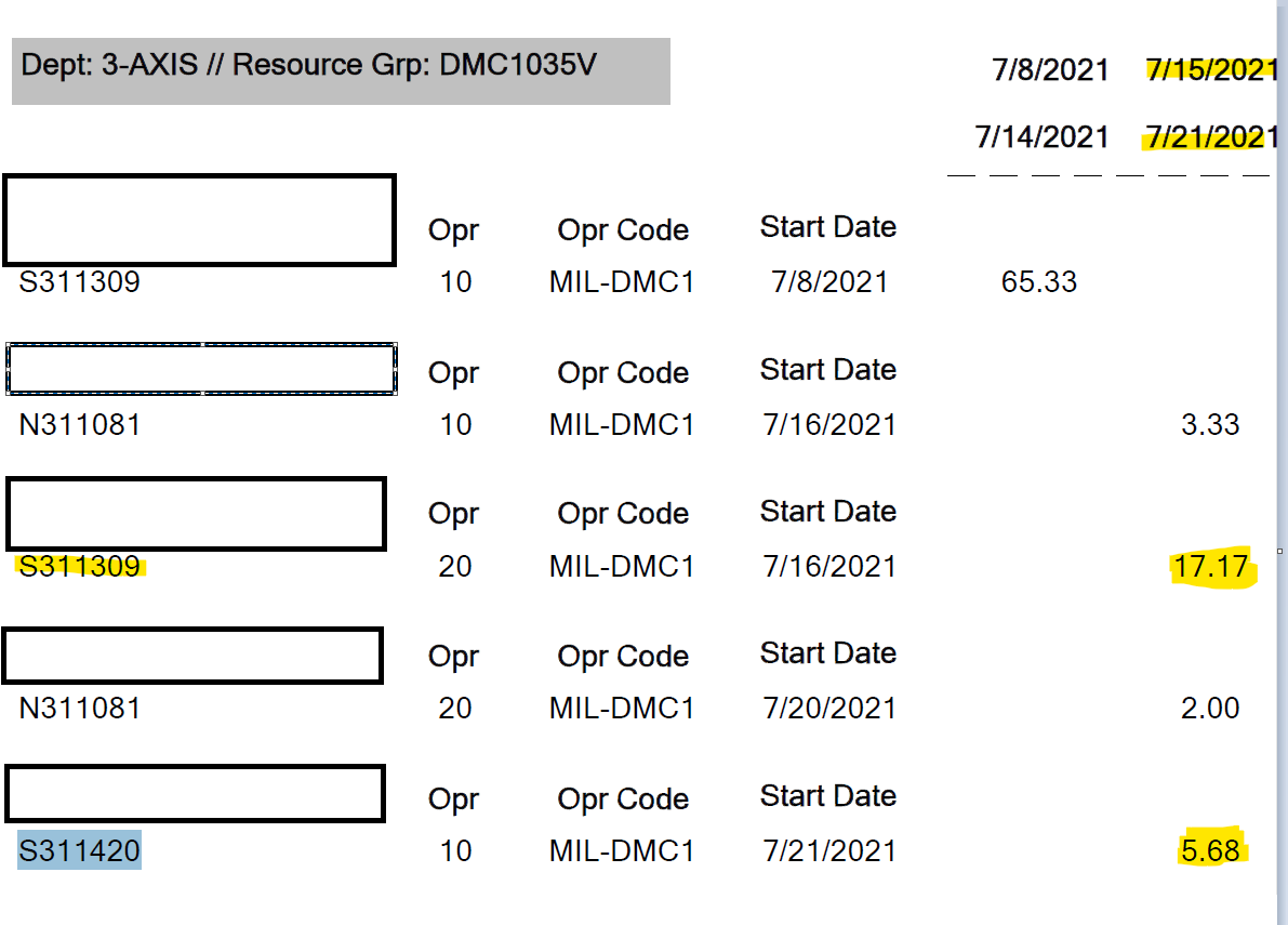

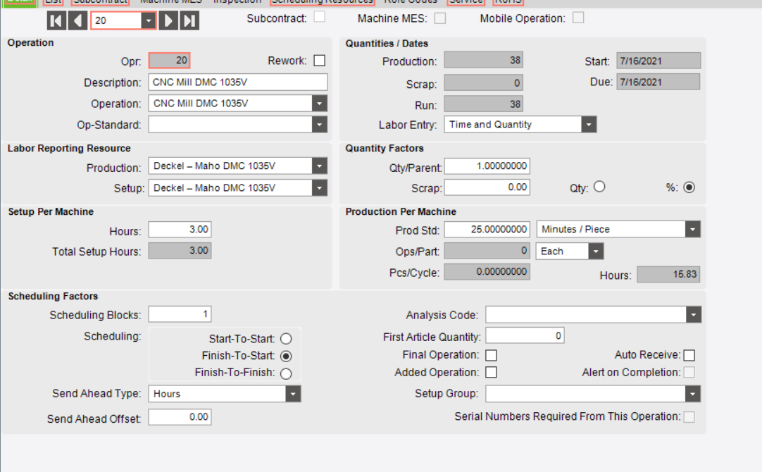

However, when I check the operation details, it says est hours is 18.83. Which is exactly what we have on our Job Entry: 15.83 prod hrs + 3 setup hrs = 18.83.
And the difference is 1.663 hours, which doesn’t make any sense whatsoever.
