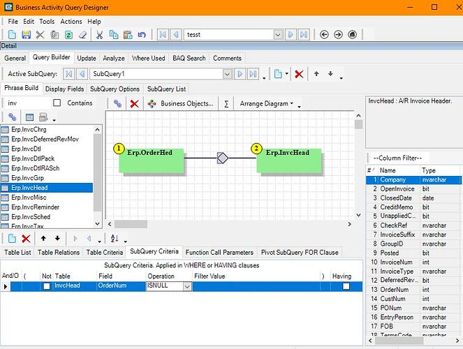

I am getting better a BAQs but I still have a long way to go. I am trying to do a BAQ on all SO Lines not invoiced. e.g.
How I just get SO Lines not invoiced i.e. SO 123 Line 3 and SO 124 Line 1.
Thanks in advance
Hi Matt,
You can set a sub query criteria for the invoice table. Something like the attached image.
Good luck!
Nate

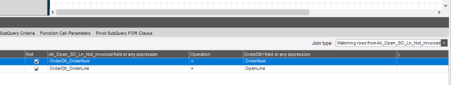

Thanks for the response Nate. I was still poking away at the query when you posted as I though I was close. It seems to work by using a matching join between subqueries and setting the NOT flag. The numbers don’t tie up with my Excel mockup but they correct
