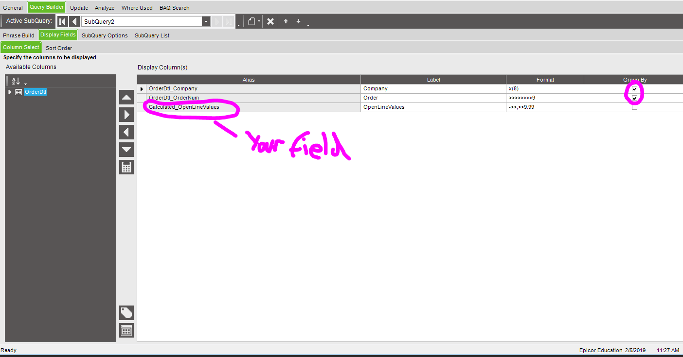

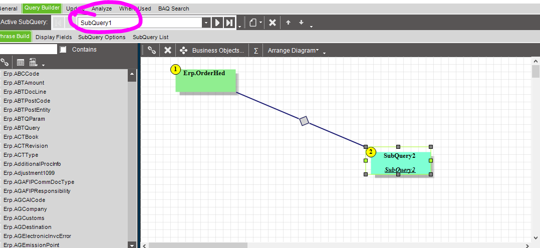

To follow up on Brandon says here:
If you in fact need those fields, you can make your query a sub query then on the top level, link your main table with all the fields you want back to the subquery.
now I am lost. I haven’t had success with that grouping field/column and now you are talking sub query. I need to educate myself a bit more…
As always, start with the help files and tools guide, but here is another thread where I walk someone through a subquery step by step.

This is the TOP level query
I included the BAQ, you can download it then import it in Business Activity Query > Actions> Import. This is the subquery. You can make a subquery by using the buttons in the subquery ribbon. I am being vague because like @Banderson said, reference the tools help guide, it will explain it a lot better than I can.
