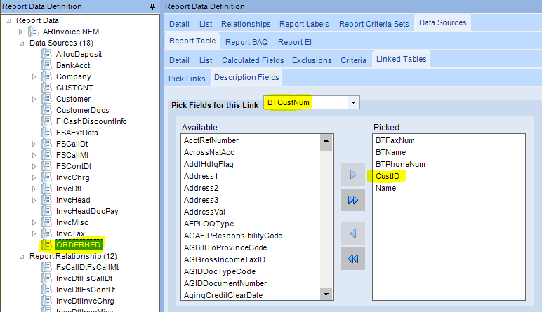

  • You can then add Linked Tables from the ORDERHED table.
  • Add “link” for the BTCustNum Table
  • Under Description Fields… add CustID (and any other fields you may want to reference in your report)

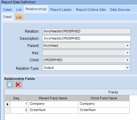

Add a relationship between InvcHead to ORDERHED (on Company & OrderNum)
Save your RDD.

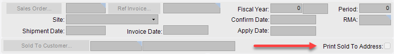

Depending on what your end goal is, if you just need to show the Sold To address, you can use the Print Sold To Adress field on the Invoice header. The Sold To, Bill To, and Ship To addresses are already part of the out of the box RDD.
Otherwise, @dcamlin has given you the instructions on how to get the CustID (and more) into the RDD.
I was able to get it to work with using the linked table. The tricky part was finding the actual field name it was being stored into was BTCustNum_CustID.
