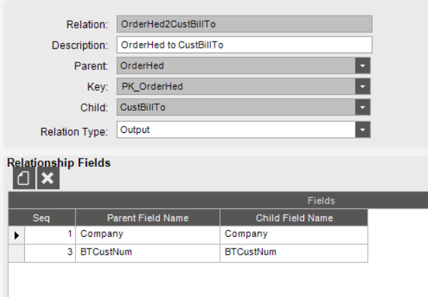

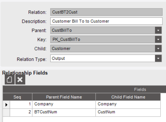

Is there a way to display both the Bill To CustID and the Sold To CustID for the Order Acknowledgement? The RDD doesn’t allow creating relationships with the same parent and child since the table joins between the two is BTCustNum and the other is CustNum. I can’t seem to get both the Bill To and Sold To CustID’s since the RDD doesn’t allow duplicate relationships.
See if this helps…
Use the BTCustNum Linked Table to get the Bill To data and the Customer Linked Table should already be the Sold To.
