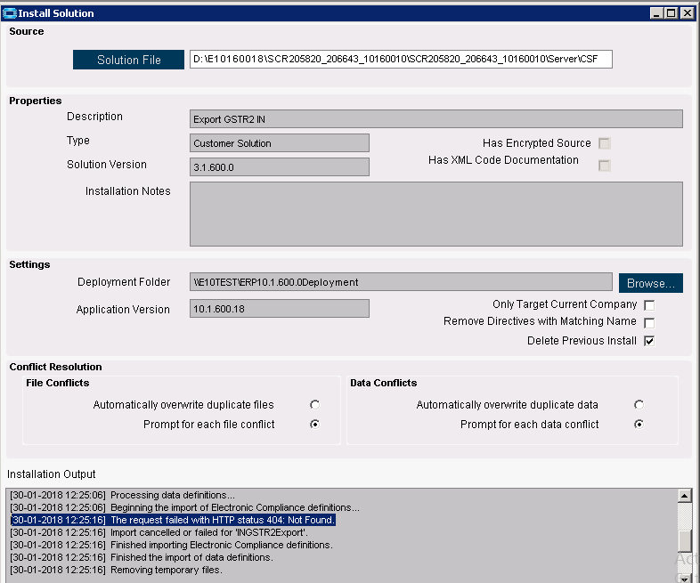

Getting this error while installing a solution. Before this it was highlighted the Error with IIS pool - asp.net impersonation is set to true, i have changed it to false. Now this error is coming ?
may be this URL is not accessible : http://localhost/ReportServer/ReportService2010.asmx
any suggestion?
solved…the ssrs database authentication was set incorrect…
