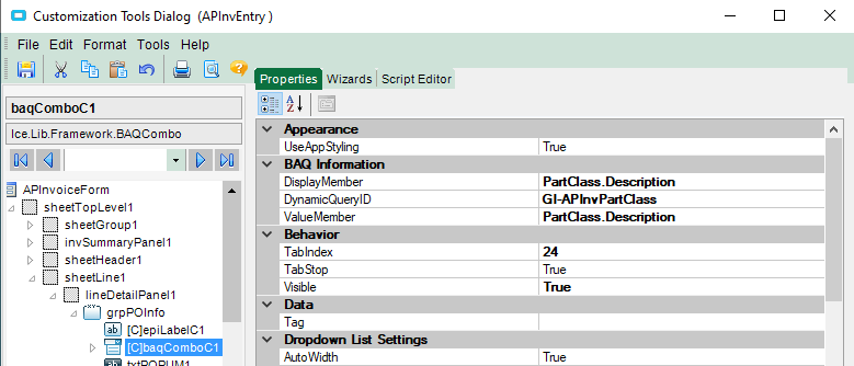

Part/PartClass is not available in the EpiBinding dropdown so I created a BAQ and baqCombo that is filtered by Part.PartNum:

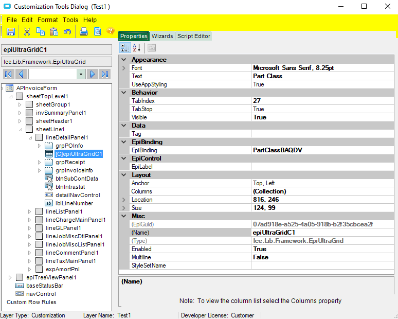

Screenshot of customization dialog:

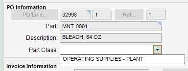

This works as far as getting the correct PartClass description in the dropdown, but I would like the dropdown to automatically select the list item.

However, the epiUltraGrid does not populate any data. The MessageBox does show up every time I view a different line item, though.
You did run this function correct? CreatePartClassBAQDV()
Which ultra grid? Ithought you had a combo box.
@klincecum Yes, it’s at the top of the InitializeCustomCode() function.
@josecgomez I am using an ultra grid for now because that’s what was used in the BAQ Dataview Example Video.
Did you bind the grid to the new Data View?
Can you share your whole customization code.

It’s bound to PartClassBAQDV:

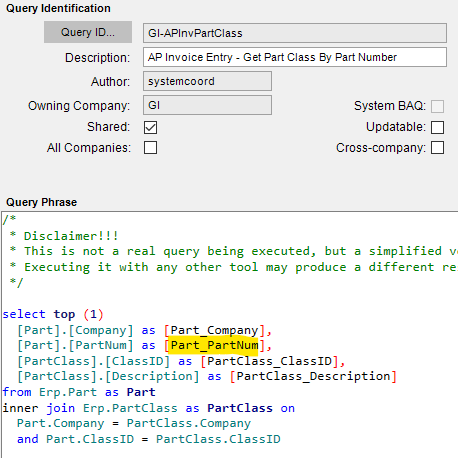

Your BAQ is using the Part table? Part_PartNum is a valid field in your BAQ? And you are hanging this on APInvoice Line and there’s a line… with a valid part?
Here’s the BAQ:

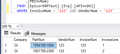

I checked the APInvDtl table in SSMS:

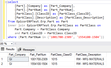

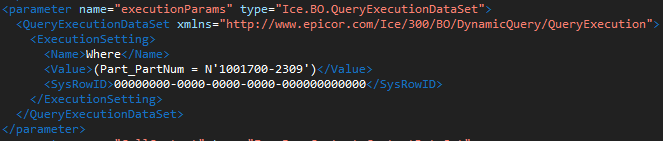

And it looks like the trace shows the WHERE clause:
Okay so it is running are you sure that’s a valid part? In your part master
I’m sure they are valid parts, otherwise the BAQ would not return any results:
