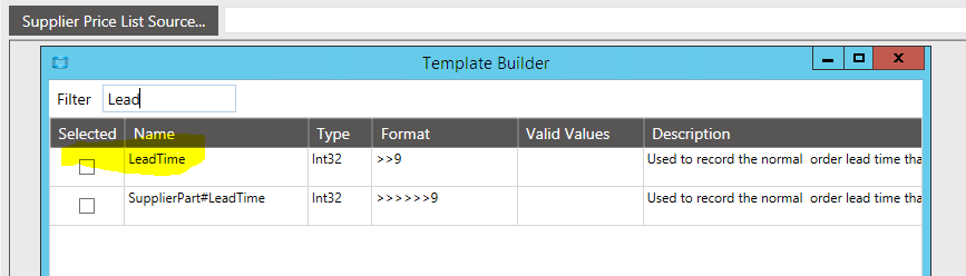

Did you try using LeadTime in the Supplier Price List template. See screenshot below. Maybe just do the required fields and add LeadTime. The SupplierPart#LeadTime looks like it is referring to PartXRefVend.LeadTime which is not what you say you are going for. Always try is your test environment first!
Thanks for the very straightforward simple answer. I usually reverse engineer the DB field by using Technical Details of Field Help. And yes, we do cross reference the vendor part numbers and when I went looking, that is the field that was getting updated, rather than the regular Supplier Price List lead time. Why it gives a different DB reference in the Field Help, I do not know…
