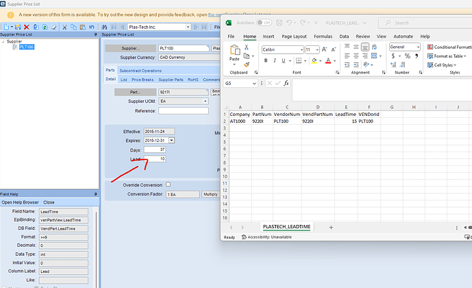

I am trying to DMT to LEAD Box in the Supplier Price List. I have used them template builder to create what I thought would be an easy DMT, but I cannot get anything to change this Box after processing MRP. I have tried Vender, Price List, Part Plant Tables, but nothing is working to DMT these parts. I could do it manually, but now this is just bothering me! Has anyone successfully DMT’d this data table?
The part number on the Excel spreadsheet is not the same as the one in SPL.
Was just using as an example. I cannot figure out where that data field is. It is driving purchasing decisions. I have changed it for a collection of parts in Part Plant, Supplier Part, Supplier Price List, but they all just keep staying the same on the price list and on the NEW PO Suggestions. I don’t understand what other data tables their are to DMT.

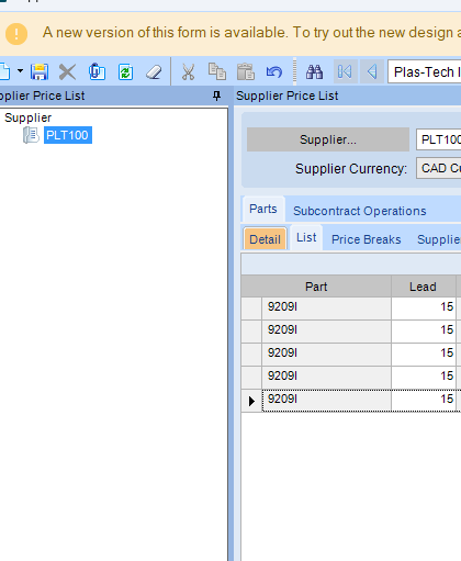

Thanks All - Updateable BAQ was awesome! It updated all the pricelists. However, I ran MRP on this part and PO Suggestion still is saying 10 in lead time!
What am I doing wrong?

Are you using Part Plant in DMT? The below columns are the only ones required to update the LeadTime, try only using these columns.
Remember, Plant field is case sensitive also so ensure this is the same on the DMT file as what it is in the system.
If this doesn’t work, let me know what message you’re receiving when running the DMT.
Yes the Part plant was the first table I looked too. No where do these parts have a lead time of 10 days, but in NEW PO Suggestions it is getting 10 days from somewhere. I for the life of me cannot figure it out.
