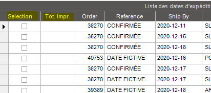

In the picture of your dashboard, SO 38270 is shown 5 times (first 3 have unique ship by dates, #'s 4 and 5 have same Ship By date). In this example, you want the first line to be just items shipped by 12-11, and the 2nd for items with ship by of 12-12, etc … And with the last two being just two copies of the same one for 12-17?

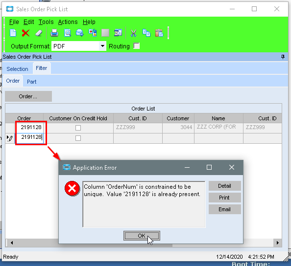

Also, It tried just printing a SOPickList multiple times by adding it to the list on the Print SOPickList form, but get:
And Even If I put them out of order (made the OrderList = “2191110~2191126~2191128~2191110”, it still only makes 3 pages.(I was hoping that 2191110 would be on page 1 and page 4)
So I don’t see how you could include the same OrderNum multiple times, in code.

Sorry, the list is repeated because of different release dates of same order.
It was to show thqat a user would select what date to print, then number of copies if necessary.
