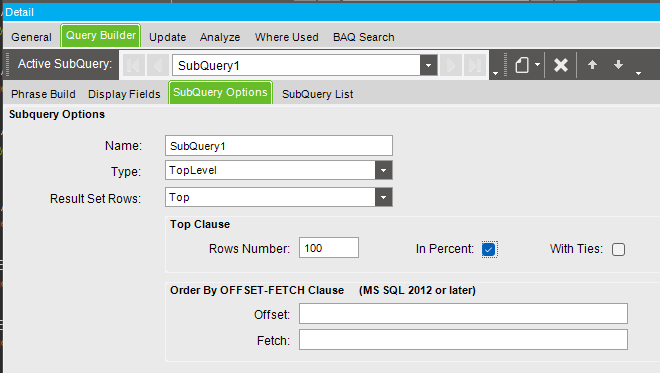

There was (I haven’t tried it in either a BAQ or SQL recently) a trick where you can enter the subquery result set as TOP 100 PERCENT and it will allow you to sort the results of the subquery.
Thank you Tyler! I didn’t know about that trick. It worked! I had to add some extra grouping, and I had to move my date field to the beginning of my subquery, but after that I could turn on order by req date, and everything is sorted perfectly! Thanks!!!

I have set the subquery as Result Set Rows = Top, In Percent 100. I am using JobOper, JobOperDtl, and Capability tables. I have JobOper.OprSeq, Company, JobNum, AssemblySeq, and my calcualted field to pull the resource group. All of these are grouped fields.
