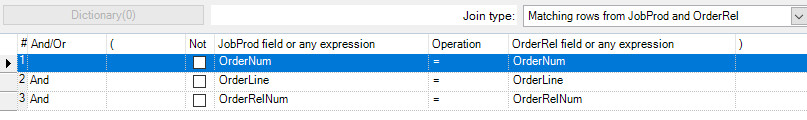

SubQuery4:
Table1: JobProd
Table2: OrderRel
Subquery Criteria:
JobProd=JobHead.JobNum
OrderRel.OurReqQty=OrderRel1.OurReqQty FOR XML PATH(’’)
The only field returned from SubQuery4:
MyQtyDate=convert(varchar, cast(OrderRel1.SellingReqQty - OrderRel1.OurJobShippedQty - OrderRel1.OurStockShippedQty as decimal(10,0))) + ’ ’ + convert(varchar, convert(varchar, OrderRel1.ReqDate, 1) ) + char(10)

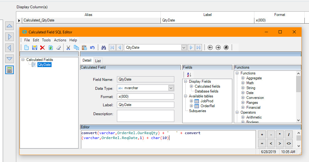

It is true that the calculated field is a string. However, it is a string that contains both a quantity value and the date. I can’t cast/convert the calculated field to date since it is not strictly a date field.
The whole idea of returning the results of a query within a single cell like I am trying to do is a bit confusing to me. Using the “FOR XML PATH (’’)” in the subquery criteria allows me to return the values into a single cell like I need. I just can’t sort the values within that cell.
I also tried putting the subquery into its own single query. I can basically reproduce the same issue I was having. However, I need this to be a subquery so that I can utilize the REPLACE functions to strip out the XML headers that get applied using the FOR XML PATH output. Regardless, I still can’t sort the values inside a single cell. Here is the single query version of the issue:
So after pulling the subquery into a single query. I modified it a bit to list the releases and dates I want and even sorted them using the display sort in the BAQ. But as soon as I move this to a subquery to include other details I get this error:
The ORDER BY clause is invalid in views, inline functions, derived tables, subqueries, and common table expressions, unless TOP, OFFSET or FOR XML is also specified.
So I can’t use order by in subqueries?
Why are you creating one field with two variables? Do you need to do this?
That goes back to the SSRS. I need one field that contains multiple fields to get my formatting correct. I believe with a different approach on the SSRS I could do this much easier.
Having said that, I seem to have come to a solution. The query below returns exactly what I need. Now I just have to squeeze it back into the big query. What an ugly mess! :smiley:
