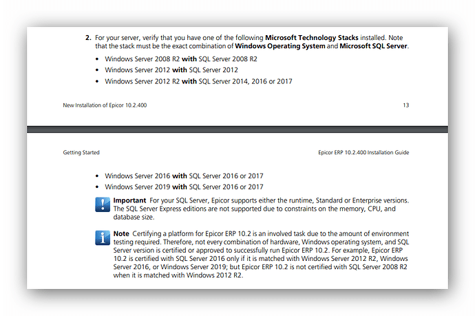

Hi guys, does anyone know if SQL Server 2019 is “certified” by Epicor to run with 10.2.400?
We are planning to upgrade our SQL platform from 2008R2 and need to decide whether to go with the 2017 or 2019 release.
Thanks in advance!

According to the 10.2.400 Installation guide, it doesn’t look like they’ve certified SQL 2019.
It is not. Server 2019 is supported but not SQL Server 2019.
Same specs in 10.2.500 install guide. no SQL2019 yet…

It was only released 4th November 2019 so we would not retrospectively certify for previous versions. It will be part of 10.2.600 regression testing processes and we do not expect any issues with prior versions using SQL 2019.

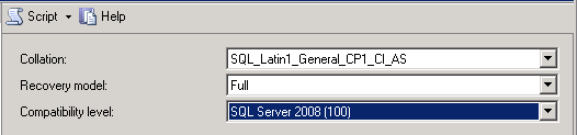

I was told by an Epicor Tech that as long as the DB version is kept at 2017 (or appropriate supported version), then that is fine.
That’s a good point Mark, you can always downgrade the Compatibility level to whatever older version is needed - thank you!

My opinion is this. Whilst you can run the database in compatibility mode, if it does not explicitly state that in the implementation or certification documentation that you can run the database in compatibility mode, I would not do it (at least not in a production environment).
A good example some of the subtleties of versions is the introduction of the TRIM function in SQL 2016. Clicking on the TRIM() string function in a calculated field in a BAQ returns the following SQL ltrim(rtrim()). So whilst you perhaps might get some better performance out of the database engine you won’t get any benefit from any coding enhancements baked into the later version of SQL. To that point I’ve never tested if you could perform the TRIM function on a database running in pre 2016 mode.
