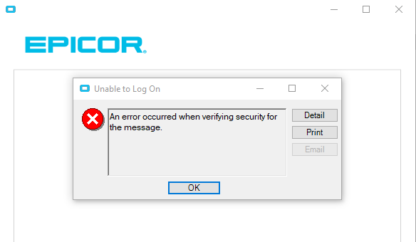

I am stuck trying to configure SSO from the standard Epicor auth. I have modified the config files, users, and everything else it notes in the admin guide and I run into the following error when I click the icon to log in. There must be something I’m missing here. Has anyone else run into this error below. I should note this is not using AzureAD and is an on prem environment.
Make sure the date/time is correct for the client and server. This is just as true for AD and Azure AD.
Thanks, I check that also. I found some other posts about that also.
This can also happen when the settings in the .sysconfig file do not match how the App server is set up.
I will do a double check on that. Thanks
Check Event Logs for Error Details.
Try changing the End Point Bindings, for SSO, use the following:
