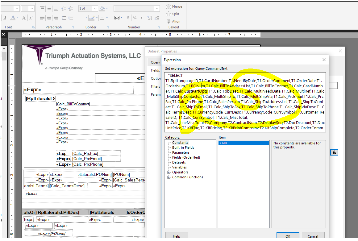

here are some more details…
I have a strange issue going on with my SO form. So I am missing some data and need to add it, no big deal. But when I go into the SSRS report and open the data set to edit the query I can’t edit it. I have done this plenty of times before. I am at a total loss.
This is where I can’t edit the report….
I just want to add a field to the query… T2.Orderdtl_Character01 and I can’t type anywhere in the expression.
The expression field is disabled?
Or after making an edit and clicking OK it gives an error/warning?
Or does it just appear to make the change ok, and when you go back in, the expression reverts back to pre-edit state?
I guess it seems like it is disabled. I can’t type anything in there. I thought maybe when I installed my solution some permissions got messed up. I even tried another form and same issue.

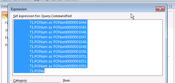

I found the issue Epicor has maxed out the allowed Characters for SSRS. I will be posting a new post on this find to see what others have found.
I will need to create stored procedure to call this dataset.
If that were true, I’d think you’d be able to delete some of the existing text. Can you do that? (Obviously don’t save after deleteing)
Edit:
Just tested it and pasting a query expresion bigger than 32,767 stops at that char 32,767
Yes I can delete text. I just don’t know what I REALLY need to keep or not. I know there are some fields that I don’t need but worried I will remove something needed or a subreport will need.
I think deleting any referenced field would give you an error upon saving.
