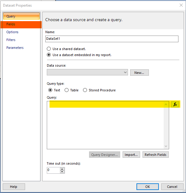

The T1, T2, etc is what the tables are aliased as in the Query. The yellow highlight is where you edit the query (by clicking on the fx button). The red highlight is where you add the query field to be able to add it to the actual report.
