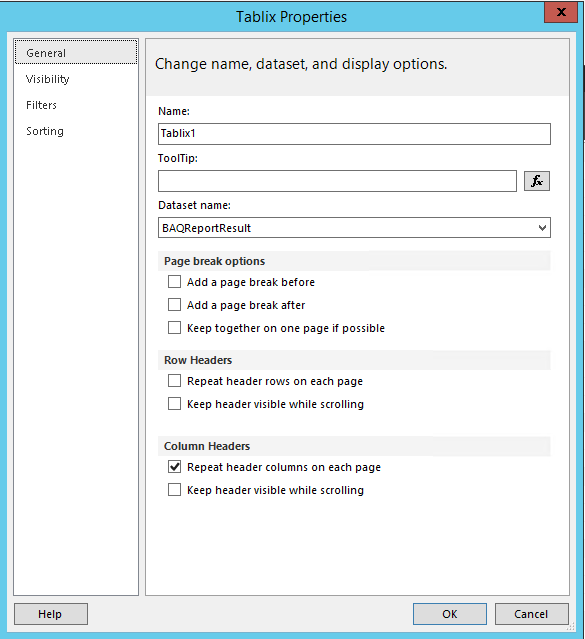

1.) The column heading don’t repeat on other pages. I do have the Column Headers repeat header flag set

Maybe try setting the “repeat on new page” property for your static row group that comprises the column headers?
I can honestly say that those tablix properties are very confusing.
I’d think that “Header Row” refers to the top row above the columns.
And a “Row Header” is the left most column.
But the section “Row Headers” has a property referring to “Header rows”.
WHICH IS IT?
Found it!!! The first column static row group needed to be set to RepeatOnNewPage TRUE. Thanks Tanesh.
