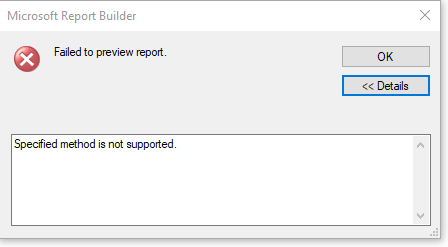

I copied the POForm over to the Custom Folder and the report ran correctly. However, when I take the guid and put it in the report o edit, it gives me this error:
Did you increase your archive period to greater than 0 when previewing to create the GUID?

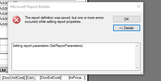

Yes. I removed the guid, and hit save, and recieved this error:
When you say “removed the guid”, what exactly do you mean? Do you mean that you removed them from the underlying query, where it has code like “POHeader_+ Guid”?
When you create an SSRS report, it creates separate tables where the GUID is part of the table names - so you can’t remove it from the query.
In the parameters, under Default values, I deleted the guid.
Did you delete the default value or did you delete the parameter completely?
Just the default value, not the parameter. And, its working this morning. Not sure what was different, but its going fine now.
