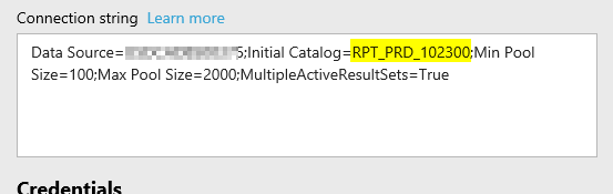

I don’t recall the exact specifics, but when setting up a new environment (new App nd SQL servers), whenever I deployed my TEST or DEVEL App, it would break SSRS printing on all the other Apps.
This was because I was specifying a different Report Database Name each time I deployed. It would create the SharedReportDataSource with a new connection string
Then after deploying the UAT_102300 App with Report Database name RPT_UAT_102300, it would change the above to ...Init Catalog=RPT_UAT_102300;....
I believe that if I had also specified a different SSRS Reports Root Folder it would have been fine, as there would have been a unique SharedReportDataSourcefor each App’s SSRS.
