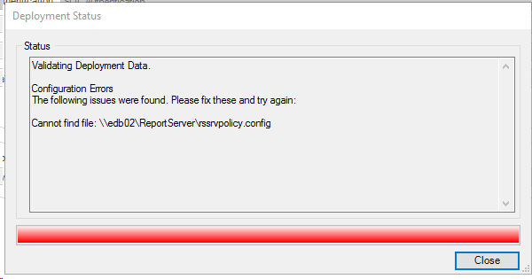

I have tried to redeploy Reporting Services, but I get the following error. The file is there. After we upgraded the SQL Server which is installed on a different drive than where the new version is installed. I am guessing that the issue might be I am pointing to a folder that no longer exists.
Is the “edb02” server online?
If so, could be the SSRS service account doesn’t have permissions to access the share/file.
Check the ReportServer share on the SSRS server. It is possible it is pointed to the old location.
Well, I have some new errors. I don’t think this is a permission issue as the folder is being shared properly.
