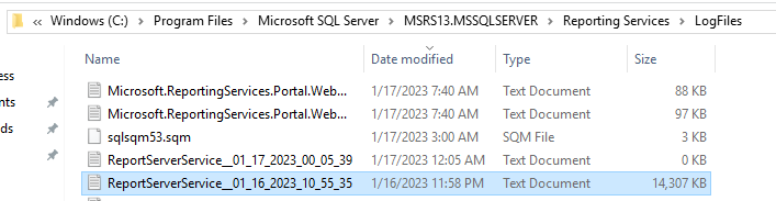

- Reviewed the Stack Trace:
An example of the stack trace, which is repeated 3 times (Default SSRS Timeout Retry Settings). I’ve truncated a lot of the duplicate lines to keep the post succinct:
