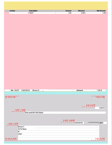

How I finally tracked the problem down… by setting different background colors on all the report sections. I also added some coordinate “targets”. This made it easier to see the results of changes to sections.
After that I was able to use a combination of changes to both section sizes and field positions.
