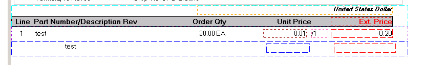

One of the fields seems to be moving on me in the SOForm.
With the Design of:
(note how the Ext price value field overlaps the field to the left)
I get
which is what I expect.
If I shorten up the Ext price value field to:
(note that the left side of the value field was moved to the right, but the right edge remained aligned with the Ext Price label above it)
But I get
Why would Ext price value field hold its location, only when it overlaps that field to the left?
BTW - that field it overlaps with is TxtLSHSHM which displays a PricePerCode (when used)
The outlines of the field where just to show the fields location when it rendered
Why…?
Just one of the many mysteries in SSRS…beyond my ability to get them to reconcile.
I can only guess is has to do with control positions relative to the rectangles that contain them… where “something” is different but what?
