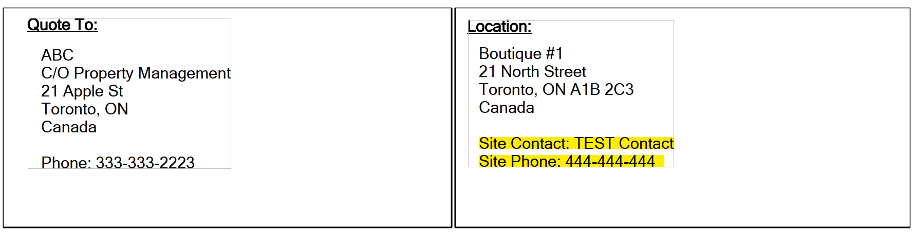

I’m trying to show only the ‘Site Contact’ information in the SSRS report but I’m not sure how to get it to work. We have several contacts for one customer and all I want to show in the report is the Site Contact Name and number.
This is what I have, but it doesn’t seem to be work.

Adding the WHERE clause in the data set query works well if there is a site contact entered. The problem is, if we don’t enter a site contact then the whole invoice is blank. I just want to Site contact field to be blank if there is nothing.
