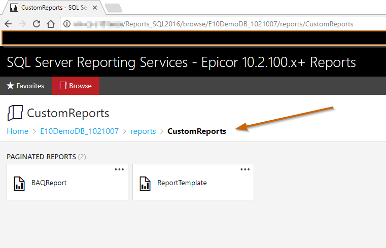

That being said, as long as the custom reports are in the \CustomReports folder in SSRS(which all custom reports created using native Epicor reporting functionality like BAQ reports or duplicated copies of a base Epicor report are located automatically), then the update will not touch them.

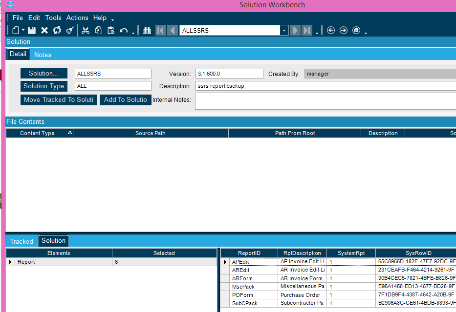

I have installed the many solutions but not yet created any single :stuck_out_tongue:
Here is a new solution entry i have done…saved the those necessary SSRS reports in solution…shoul i build the solution ?
The Build solution option is grayed out… what is the next
