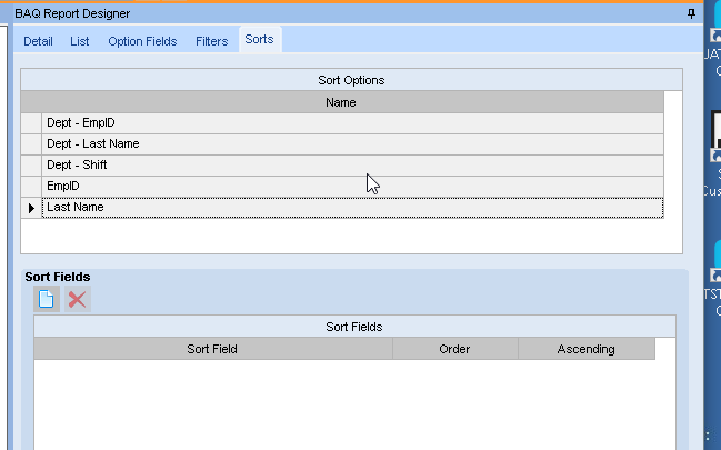

I have 4 different sorts established in Report Designer, but they do not carry through to the SSRS report

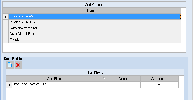

The Sorts you add in “BAQ Report Designer” can either affect the data set sent to SSRS (by pre-sorting them), or merely add parameters that are passed to SSRS.
In the following I’ve added 5 sorts to the BAQ Report.
The first one appears as “Invoice Num ASC” in the dropdown, and has a “pre-sort” on InvoiceNum (ascending) applied to the dataset, as specified in the lower pane.
The third displays as “Date Newest first” in the dropdown and pre-sorts on InvoiceDate
And the last one has no presorts.
Why would you use the last one? It does no pre-sorting to the dataset, but it is passed as a parameter, which could be used for complex sorting (or filtering) done in SSRS.

Below are my 5 sort options
Dept - EmpID
Dept - Last Name
Dept - Shift
EmpID
Last Name
I hope the way I am wording all of this makes sense.
Thanks again.
Carol

  1. Make a Sort entry for each of those, with the “Sort Field” pane blank for each

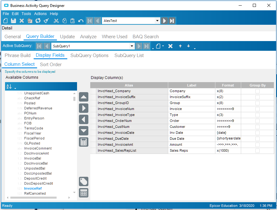

So here is what I was talking about, I created a very basic BAQ just hitting the Erp.InvcHead Table:
I then created a BAQ Report and added 2 Sort Options to it…
When I test the BAQ I get the following Objects created in the Reporting DB
taking this one step further, i can see my sort options in the BAQReportParameter table
Now go grab the RDL and take a look at the Dynamic SQL Query
It should be something similar to the following (YES I FORMAT MY SQL FROM ONE LINE TO MULTILINE) :
