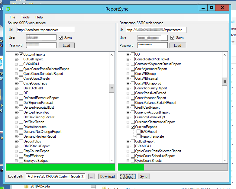

All apps in the 10.2 setup refer to the same SSRS URL. How do I differentiate which DB is used when using tools outside of E10. For instance, ReportSync only asks for the SSRS URL. In the pict below, ReportSync is running ob the SQL server of my 10.1 system. The left side is connected to the local (10.1 SQL SSRS), and the right to the SSRS for my 10.2 system.
I only want to bring the CustomReports folder to the TST_102300 environment (which has RPT_TST_102300 as its report DB).
But how do I know that it won’t end up in the DB the RPT_PRD_102300?

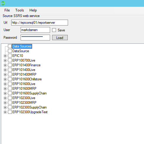

My Epicor App servers are all using their own folder on the ReportServer, and inside each will be a CustomReports folder.
That is I believe controlled by the root folder:

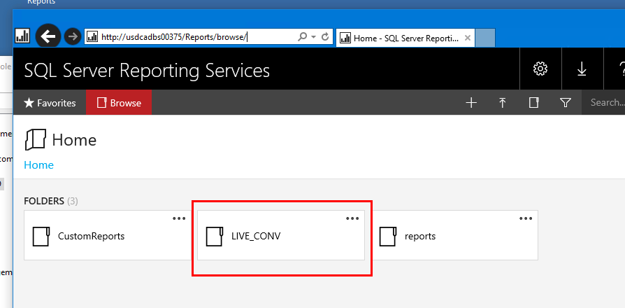

I’ve re-deployed the app, assigning a root folder of LIVE_CONV, And see the following when browsing to the reports
Do I need to include LIVE_CONV in the paths in Report Styles? Or does the App Server automatically know to look for the reports folder inside the LIVE_CONV for the reports folder?
The Report Style paths stay the same – reports/CustomReports/XYZ_Report/ABC.rdl. Epicor prepends the root folder, so it will look for that file in the assigned root directory for that environment – and if you move a Report Style from Pilot/Test to Live, you just need to copy the rdl to the new root folder and don’t need to change the path specified in the Style.
