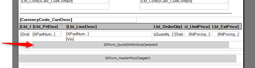

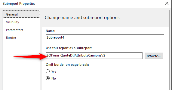

We’re “On-Prem” but here’s what I typically do:
1- Create the .RDL file on the server for the sub report
2- In the main report .RDL file, insert the Sub Report

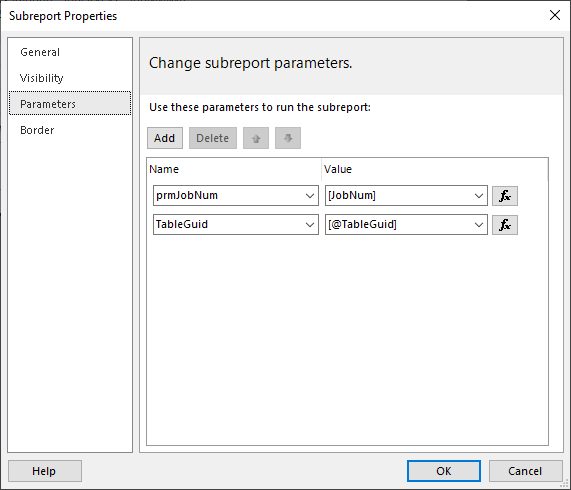

3- Still in the main report .RDL file, subreport properties, set the parameters needed to be passed from the main report to the subreport

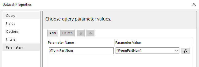

4- Open the subreport .RDL and setup the parameters passed from the main report
5- In the subreport dataset properties, map the parameters

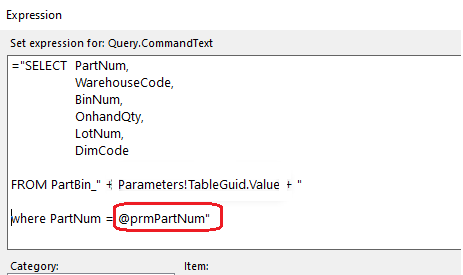

6- In the subreport dataset query, add the parameters wherever needed
